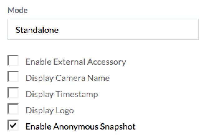

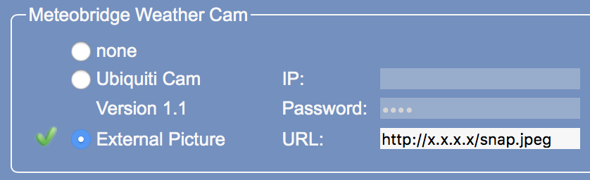

I got my UVC G3 cam from Ubiquiti running. What you need to do is to allow for "Enable Anonymous Snapshot" on settings page. Please also assign a fixed IP to the cam. Having done so your can grab pictures from it by selecting "External Picture" in Meteobridge Weather Cam section on "Station" tab and giving this URL "http://ip-of-the-cam-in-your-lan/snap.jpeg".

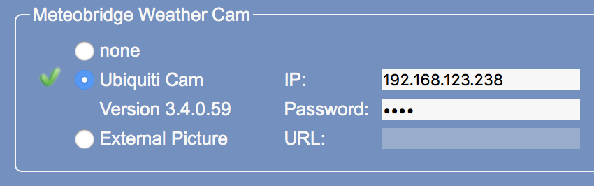

To my surprise the UVC G3 can also be handled as a regular Ubiquiti cam in Meteobridge. Just give "ubnt" as password. I you don't want the Ubiquiti watermark, you can deselect that on settings page of the G3 itself.
