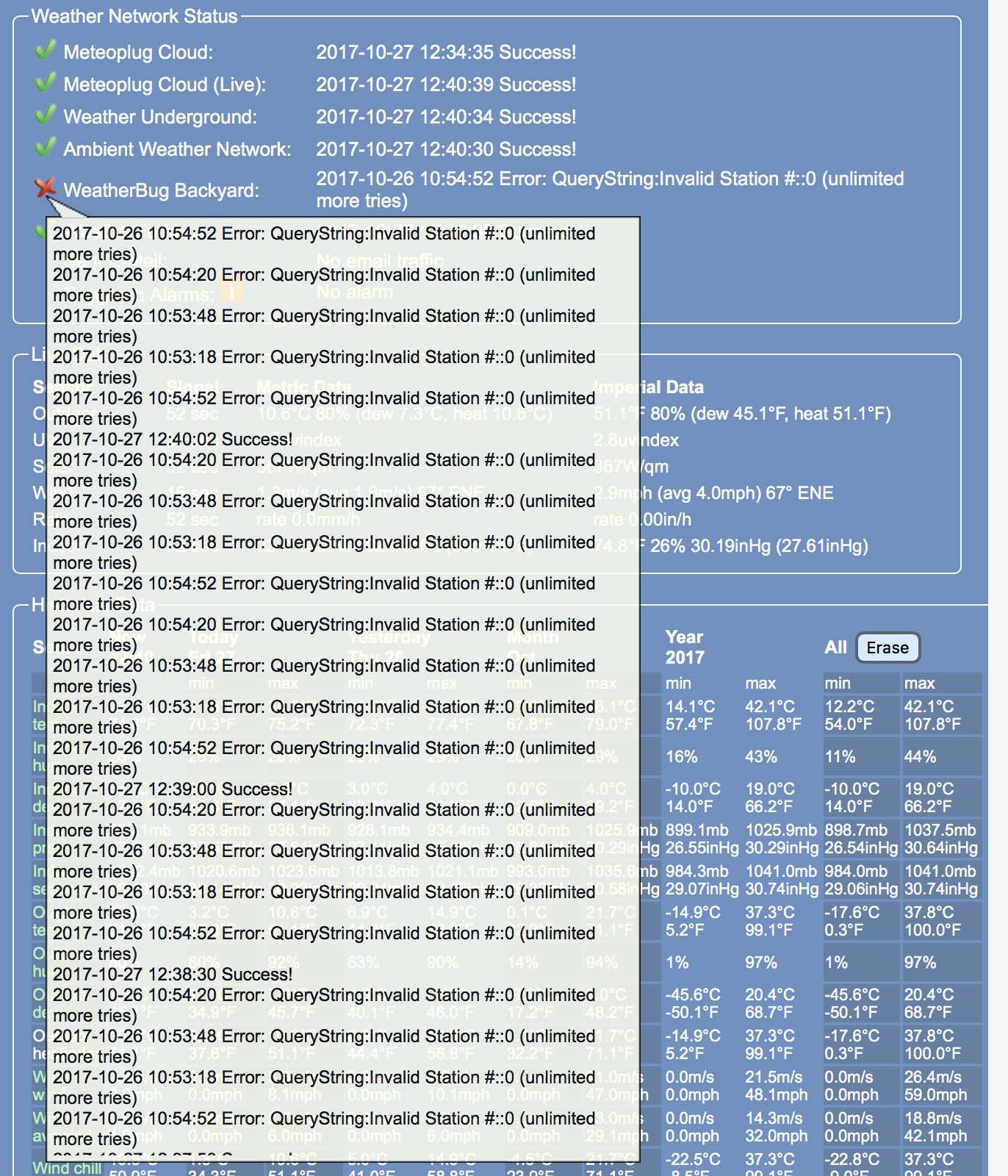

The list of past attempts to send data to WeatherBug network shows inconsistent results. See attached screen shot. Successes are every minute but listed among failed retries from hours ago. Although it reports an invalid station #, the number is correct and the Weather Network tab shows green check box next to the Publisher ID, Station #, password

"Unlimited Retries" is not a good idea, as weather bug does anyway not handle packets from the past.
Please change to no or just a few retries and reboot Meteobridge to get rid of your cached unlimited retires with faulty credentials.
BTW: Weather Bug has been sold to a new owner to my knowledge, may be it is not working well anymore.
