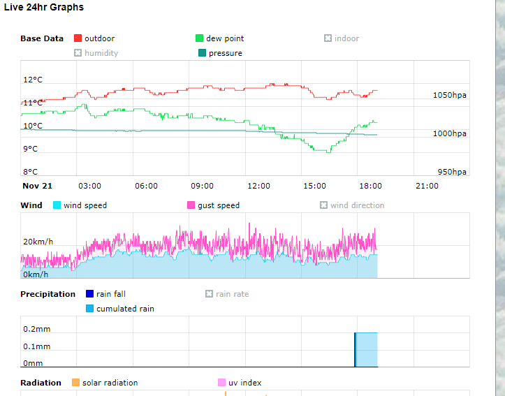

I display allinon-iso on my website, I would like to keep the temperture at centigrade and rain fall in mm but I would like the wind speed to be in mph not km/h, is there a simple way to do this.

Yes, all the chart scripts are simply text files, copy allinone-iso to a name of your choice and edit the applicable lines for the values you require.

Thanks for helping, how do I get to where the files are stored so I can copy and edit.

\\your-meteobridge-ip\data\templates
