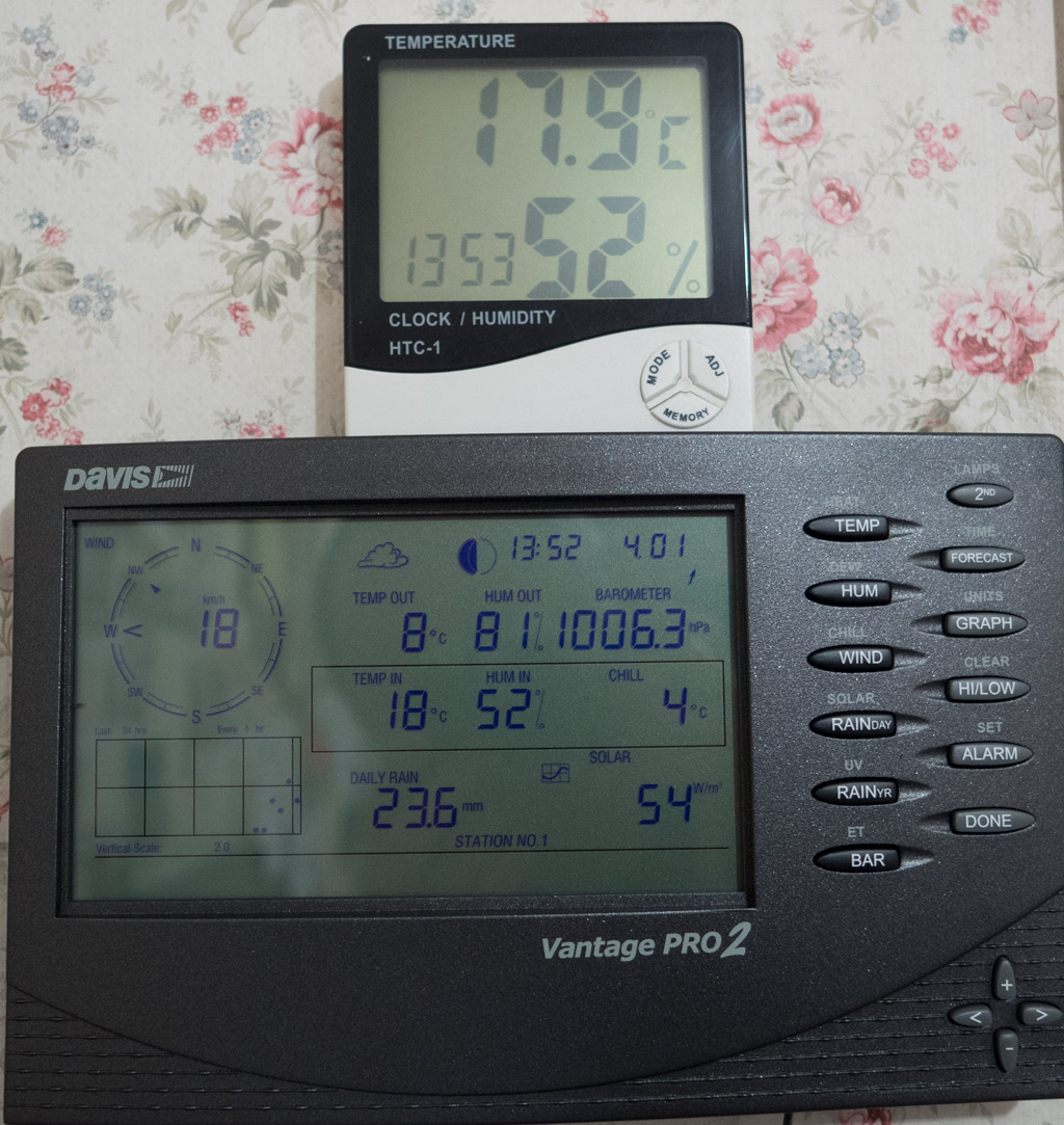

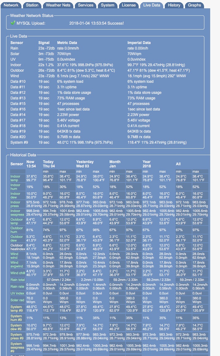

Please see the attached photo of Davis console and screenshot of Meteobridge live data, taken at the same time. (The Meteobridge is situated just below the Davis console.)

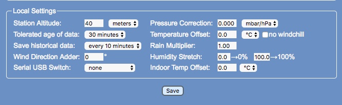

Maybe there is an offset at the WeatherStation tab?
Re: Meteobridge variables return incorrect values
MB PRO has an internal temp sensor which is affected by heating up of the unnit. Davis indoor temp/hum/pressure data is not transmitted via RF from the sensors but measured inside the Davis console. Therefore, we don't have a chance to read out this data. With the calibration proposed by wvdkull you should be able to get somehow reasonable data, but not totally accurate indeed. But come on, indoor data is not interesting for a weather enthusiast! ;-)
