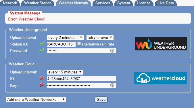

any idea why I get the red X's?
updates are occuring.....
well maybe not....
WeatherUnderground is fine.....
this is a new installation

You can get the red cross when running/flicking between tabs multiple times in between the 10 minute upload interval, essentially when accessing the tab it tries to do an upload irrespective of the 10 minute interval and then decides no more attempts are possible within the period.
Let it sit for a while (> 10 minutes) then check the output again, if unchanged then it's a different problem.

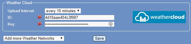

Re: System message: Error: Weather Cloud:
As Mattk explained, each time you go to "weather network" page the credentials you specified for all the weather networks are tested by sending a dummy request to each of the networks. Some networks don't differentiate if it is a request with true data or just one testing the credentials. As a result a network that limits uploads to every X minutes will report a "too many uploads" error when you visit the weather network page multiple times within the X minutes.
So don't rely completely on the green or red marks on the weather network page, take it more as indicators if your credentials are right. They might be right, although the red cross is shown.
It would be great if all networks have a function to verify the credentials only, but just very few are thoughtful enough to understand that this is a good feature that improves quality of feeding programs and helps users to drill down to root causes on error situations.

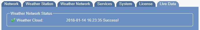

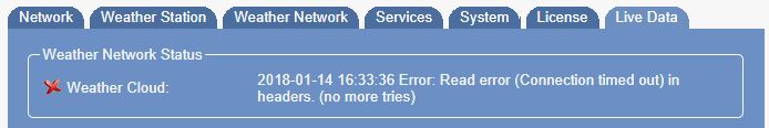

WeatherCloud has a problem or I do. I have 8 hours of this.
2018-01-22 23:09:37 Error: Read error (Connection timed out) in headers. (no more tries)
2018-01-22 15:29:52 Error: Read error (Connection timed out) in headers. (no more tries)
But it looks as if my info is going to the site. The other sites I have setup seem to be working fine.
Looks like their server cannot cope with the increasing load. -> time out
