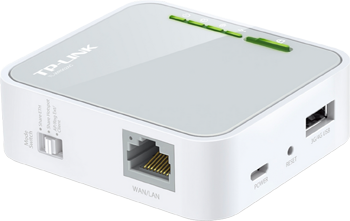

New hardware TL-WR902AC from TP-Link has been added to the list of supported devices. Hardware section and Preparing Hardware section are updated and explain how to flash these devices.
The WR902AC offers twice the RAM and Flash-ROM compared to MR3020, which makes developing SW for it a bit more relaxed. Feature-wise Meteobridge on this device is identical to all the other non-pro Meteobridge platforms. While WR902AC is able to operate on the 5 GHz band Meteobridge is currently only operating in the standard 2.4 GHz Band. This shouldn't be an issue as there are rarely any 5 GHz only WLANs and 2.4 GHz has anyway better RF reach and we don't really need top speed for Meteobridge operation.
If the WR902AC also needs a USB hub to connect to USB 1.x weather stations is not known yet. It also has an Atheros chip, but it is another model and may be the drivers for this model do it right now... we 'll see.
The port to WR902AC made switching from openwrt to lede on OS level necessary, so we had to setup a complete new compile chain. Therefore, the port might still have some bugs. If you discover some bugs, please report and please be a bit patient if fixing takes a few days. Currently the WR902AC is sold as hardware revision 1.x. You can see from the TP-Link pages that they are preparing to release a version 3 model, which seems to use different hardware. So take your chance to get a version 1 WR902AC which are widely available on world-wide level right now.
