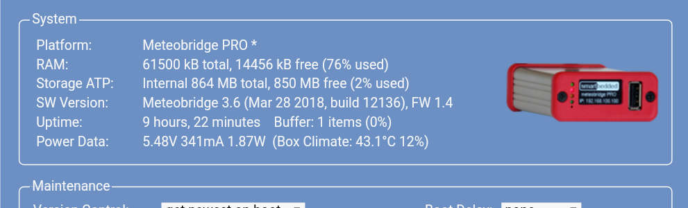

On the System Tab, System box what does the Storage line read?
websign
Posts: 25
Joined: Thu Nov 16, 2017 12:28 pm
Re: How to connect via SMB from Windows 7
Post by websign »
Attached the screenshot. Thanks for support :)
Posts: 1476
Ok there shouldn't be any issues with that ATP USB
