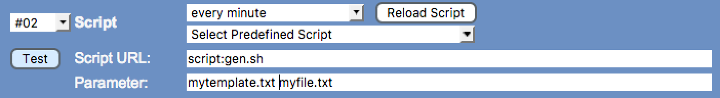

3) define a script service like this:
Screen Shot 2018-04-08 at 16.01.28.png (30.49 KiB) Viewed 2116 times
4) generated file can be found on PC network share in export folder
