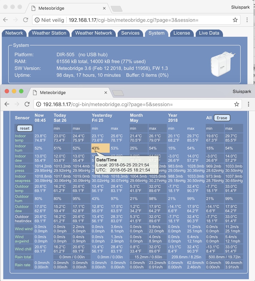

Re: Mouseover tooltips missing on Live Data tab
Working correctly here with Google Chrome Versie 66.0.3359.181 (Officiële build) (64-bits)
mikejeep wrote: Sat May 26, 2018 4:31 pm
wvdkuil wrote: Sat May 26, 2018 8:50 am Working correctly here with Google Chrome Versie 66.0.3359.181 (Officiële build) (64-bits)
Hmm, same version of Chrome for me, but I am on the May 8 release of Meteobridge and I see you are on February 12. Perhaps something changed in Meteobridge between those releases?
-Mike
I did a reboot. Now running Meteobridge 3.6 (May 13 2018, build 12196), FW 1.3
And the "tooltips" are shown as usual.
It looks like a problem of a "security" setting in Chrome to not allow pop-ups and-the-likes.
Could you test with FF or Safari?
And do a reboot of the Meteobridge to see if May 13 build has the same problem at your device/browser.
A last resort would be to set at System tab => Internet Remote Login:, copy the URL and try that from your phone (on 3G or 4G) or a neighbours PC/Mac.
