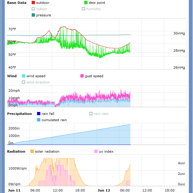

I have just noticed the Meteobridge is showing false rain readings. I have changed the Vantages battery and checked the transmitter board and all looks clean and water proof. It also shows rain when the collector is unplugged. Other readings are not quite right looking at them.
The meteobridge knows these readings are wrong!
From the system log:
logger (12.06.2018 08:53:33): suspicious and ignored rain counter reset (former value was 105) which might be caused by a power outage of the sensor.
The Davis base station says there has been no rain which is correct.

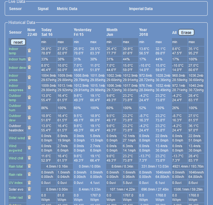

I have also got another Meteobridge running off the Davis receiver via the serial output. Look at the rain totals This does not show the continuous rain (neither does the (davis console) as shown below. First the Meteobridge via the Davis console...
Meteobridge via Davis console.PNG (58.69 KiB) Viewed 14025 times

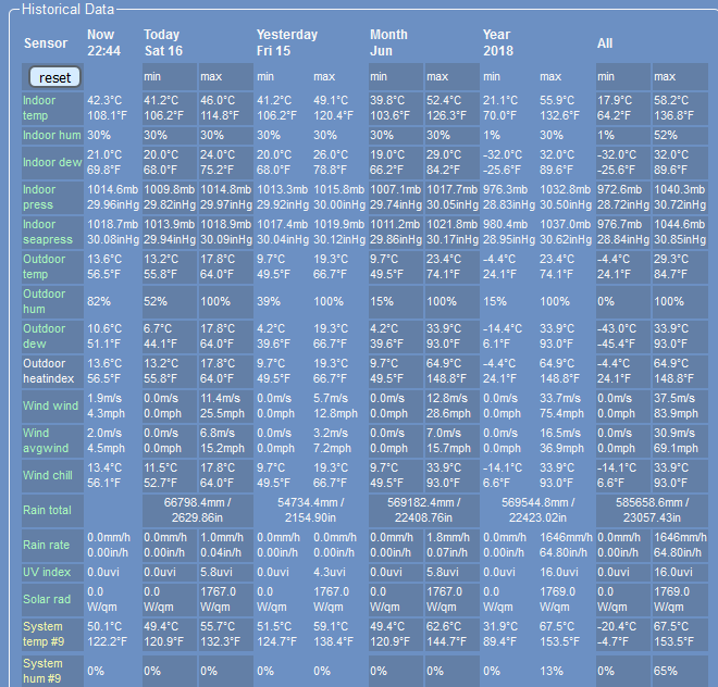

Then the Meteobridge Pro via it's own receiver:

So it is the Meteobridge Pro that is showing a false reading!!!!
Meteobridge Pro via its RX.PNG (58.43 KiB) Viewed 14025 times
