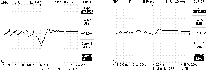

As average power consumed by a NANO-equipped console is well in specs of the Davis power plug I made some experiments with adding a larger capacitor. Idea is to get the spikes compensated and to check this I monitored the voltage reaching the NANO computing module with my scope.
On the left picture you see the voltage the NANO receives from a console powered by the Davis power plug. When WiFi starts operation the voltage drops down to 3.1 V on certain spikes which is dramatically below the 3.6V needed for stable operation of the NANO's computing module. No wonder that it reboots being punched so badly.
The picture on the right shows the same spike situation with a 1000uF capacitor applied. As you can see voltage does stay above 3.8V which is a huge improvement and also gives some headroom to the recommended 3.6V minimum level.
The result of this finding is, that I think a Davis power plug replacement can be avoided by adding a suitable large capacitor to the NANO. Looks like I will have to free up the PCB a bit to find some room for a large SMD capacitor and by that dropping the need for a new power plug. :D

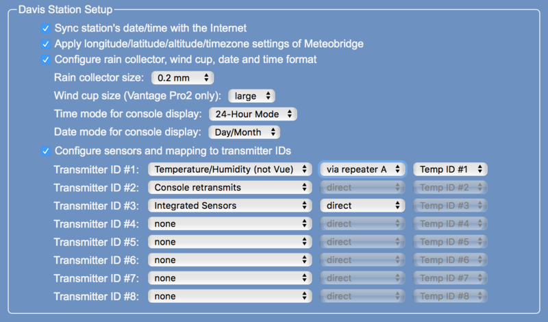

Newest Meteobridge version allows to initially setup Davis Pro2 and Vue consoles. As the NANO is just a variant of the Meteobridge SW family it automatically benefits from this as well. Please see the picture below to get an impression how this setup looks like. Setting up your Davis station can hardly be any more simple ;-)
