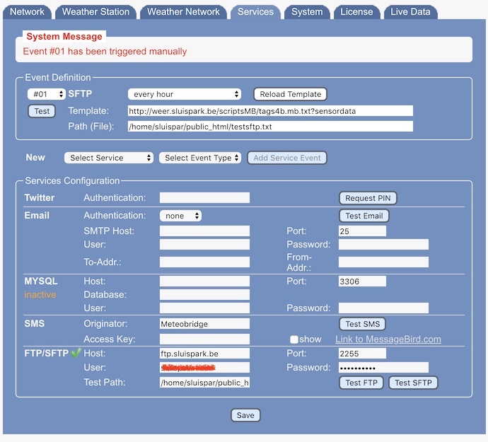

Which version of Meteobridge are you using?heersje wrote: Mon Jun 25, 2018 11:08 am I cannot get SFTP to work so want to pick your brains to see what I am overlooking.
With those settings (except the path) I can login the SFTP server with e.g. filezilla
I also tried defining a service (succesfully loading the template first)
When I try to load a template from a https:// site I get an error message "support not compiled in"
1. you are using /subdomains/weather in your example and /subdomains/weer in the image.sftp://xys.net:password@xys.net.transurl.nl:22/subdomains/weather
but get this error message
Error: Couldn't read packet: Connection reset by peer
suggestions much appreciated
Jean-Paul
Which one is correct, or maybe they are both invalid as you also mention
2. Is the port correct? Some providers, like mine, are using other portsWith those settings (except the path) I can login the SFTP server with e.g. filezilla
3. Most important is the path correct?
The path is NOT always the same as when you are using FTP.
SFTP and FTP are different server-programs and often has a different starting folder.
And the user-starting folder can also be set differently for every sftp/ftp user in your CPANEL.
The test fails when the path is incorrect.
Carefully check with filezilla without any extra path setting at all.
Than test to check if the sftp connection works, using exactly the same host / user / path / port / password as filezilla uses.
Use your CPANEL to check the starting folder for the user.
After succesfull upload you can compose the path based on the location where Meteobridge stored that test file.
The test-file test-upload has a length of 30 characters and contains the date time it was uploaded and maybe you have to check different folders using filezilla to find where it was uploaded to.
4. As long as you are only uploading to 1 website, there is no need to use ftp://user:password@......
5. Also DO NOT use special characters in a password, see other topics about that in this forum
- sftp2.jpeg (134.72 KiB) Viewed 4718 times

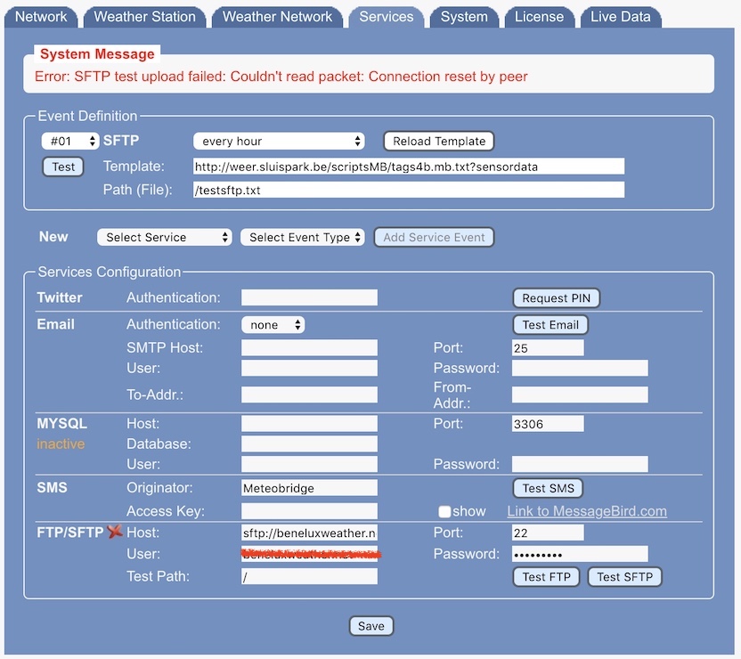

Ok, I tried with tansip and indeed it is not working at all.
They support port 22 and 2222 both do not work.
With or without sftp://
All according to transip's documentation https://www.transip.nl/knowledgebase/ar ... filezilla/
Attached a screenshot.
I will mail meteobridge support the url of the meteobridge and ask if they can take a look,
- transip.jpeg (177.77 KiB) Viewed 4709 times

I used all combinations possible
with or without sftl://
port 22 or 2222
/ or /www or /www/
No success,
port 22 or 2222
/ or /www or /www/
No success,
