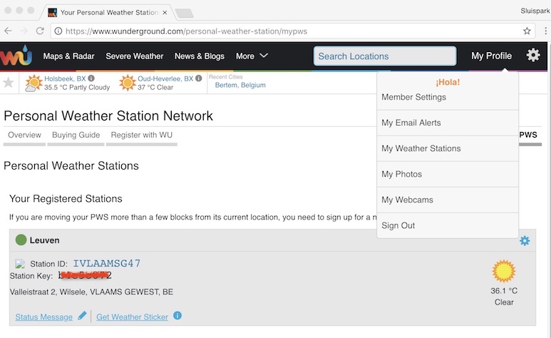

You need a WeatherUnderground account and a "registered at WU" weather-station for that account
Login to WeatherUnderground account
At the right you see "My Profile" Click on that.
The dropdown shows "My weather Stations" Click on that
The page with your registered stations appear.
If you did not register your station yet, you can register it there.
You will then get the Id, something like IVLAAMSG47 (it is always in CAPITALS) and a station key you need for uploading.

Thanks, I have account now with Station ID and Password. Problem solved.
