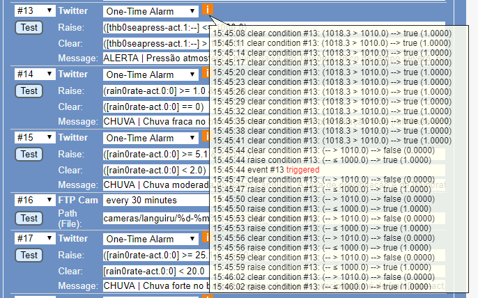

And there is a way to avoid alarm trigger when there is a lack of signal? Almost everyday my alarms are triggered and I don't know way there is this lack of signal for some sec/minutes:
Sem título-1.png (231.44 KiB) Viewed 2882 times
Re: Alarm Conditions - Help
Interesting, I didn't realize that "--" might give a true when compared with a number. However, simply replace "--" in your definition by another default value that does not hit the trigger. For the clear condition "0" might do the trick, in rise condition "9999" should be fine.
