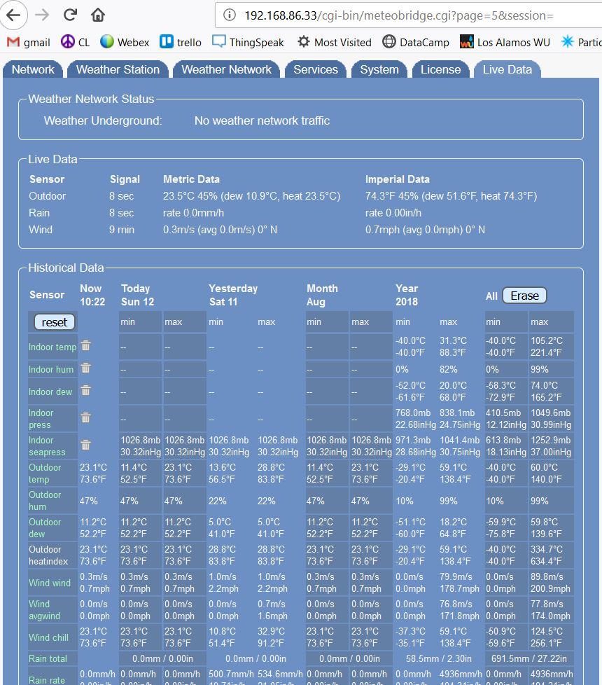

I have a tp link mr3020. My wireless router was changed and I was trying to reestablish the connection. I purchased and updated the license. I got it reconnected via LAN but seem to have problems with the wifi connection. I am able to see the data in the meteobridge ui but it is not publishing to Wunderground. I am getting this error of no weather network traffic:
I am using an Ambient WH 1080 and the console also shows good outdoor data which shows in the meteo UI data page indoor data which does not show up on the data page in meteobridge.

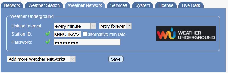

The Weather networks looks validated
but when I go to the WU page there is no data. It looks like it is publishing zeros for the data. WU does not say the station is offline.

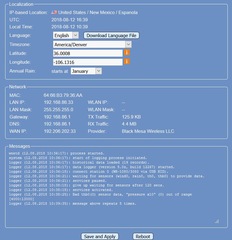

I have recycled power, unplugged console as directed in the FAQ here, to no avail. Also, not sure why the meteobridge will not connect to wifi. Here is a system log shot:

Without pressure data, no uploads are done to WU. Why don't you have the indoor and pressure data? defective station?
