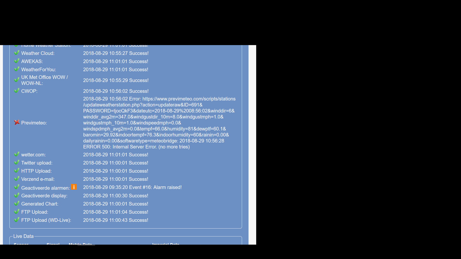

Me meteobridge uploads data back to them, only the meteobridge gives another message (see picture)

Re: Previmeteo.com storing
They seem to have trouble with their server "Internal Server Error" . I cannot do anything on this. May be they change and test more things as just the unwelcome surprise to force HTTPS which they invented a few days before.
