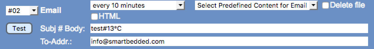

I tried with a Meteobridge PRO as shown below:
Screen Shot 2018-09-05 at 11.26.16.png (28.41 KiB) Viewed 3043 times
this results into the following mail showing up in my mailbox and the message is shown fine as "13°C". Below you see a transcript of the raw mail data coming in.
