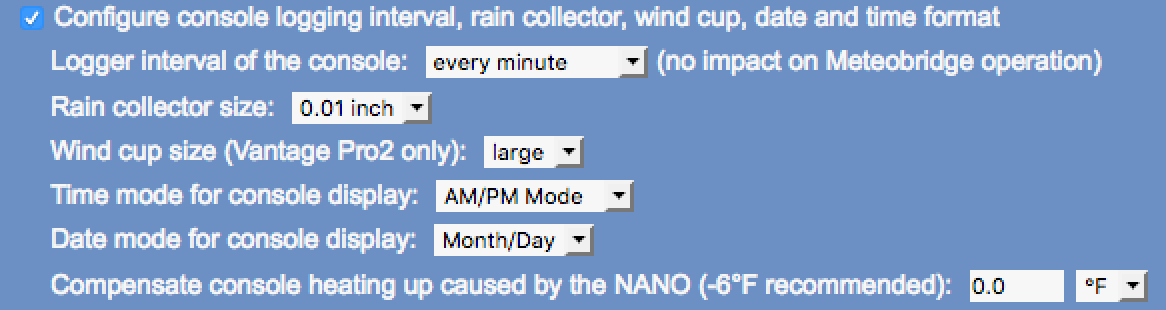

In order to have the users to easily compensate for that, Meteobridge NANO allows to set an indoor temperature correction on the Meteobridge web interface (tab "Weather Station", optional menu "configure console"). The attached picture shows where to enter a correction value to be added to the data coming from the indoor sensor. You just have to apply this once, as it is stored in the console EEPROM and also affects the console display not just Meteobridge operation.

It is obvious, that a constant adder does not solve the issue perfectly, but when the console is powered up for a while adding a constant value should be good enough. During start-up there might of course be some overcompensation.
