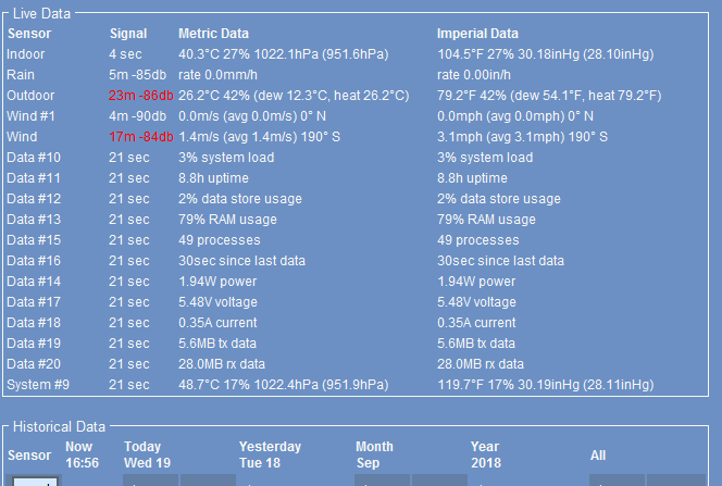

unfortunately I have very bad reception at the moment, as I think from the outdoor station and anemometer (radio) to the metebridge pro. The location has not changed. This morning, I received next to nothing, but tonight it shows a little bit of value.
What else could I do to make it normal again?

Signal is to week to get received reliable. Mattk's proposal to use console for repeating is the way out.
