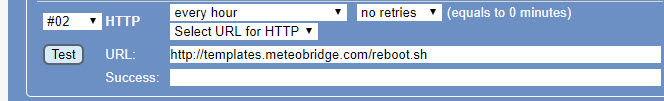

I need help, I have the weather station Acurite 5-in-1 with the Acurite Internet bridge connected directly to my Meteobridge Pro device.
I got issue with the reception of the data, the Meteobridge stop to treat the data. Then on my web site, the temps show 0 degres.... The way i found to fix it, is access the meteobridge web page and make a reboot. After the reboot, everything come back working for couple of hours only.
I try to program a script to reboot the meteobridge device each hours as per the documentation, but don't work at all. I also try to click on the test icon but the reboot don't append.
Can someone help me. I attach a creen capture of the script setup.
Thank you for your help.
Sylvain Cadieux
scadie@scadie.com
Re: Script not working
You selected a HTTP service instead of a script service.
