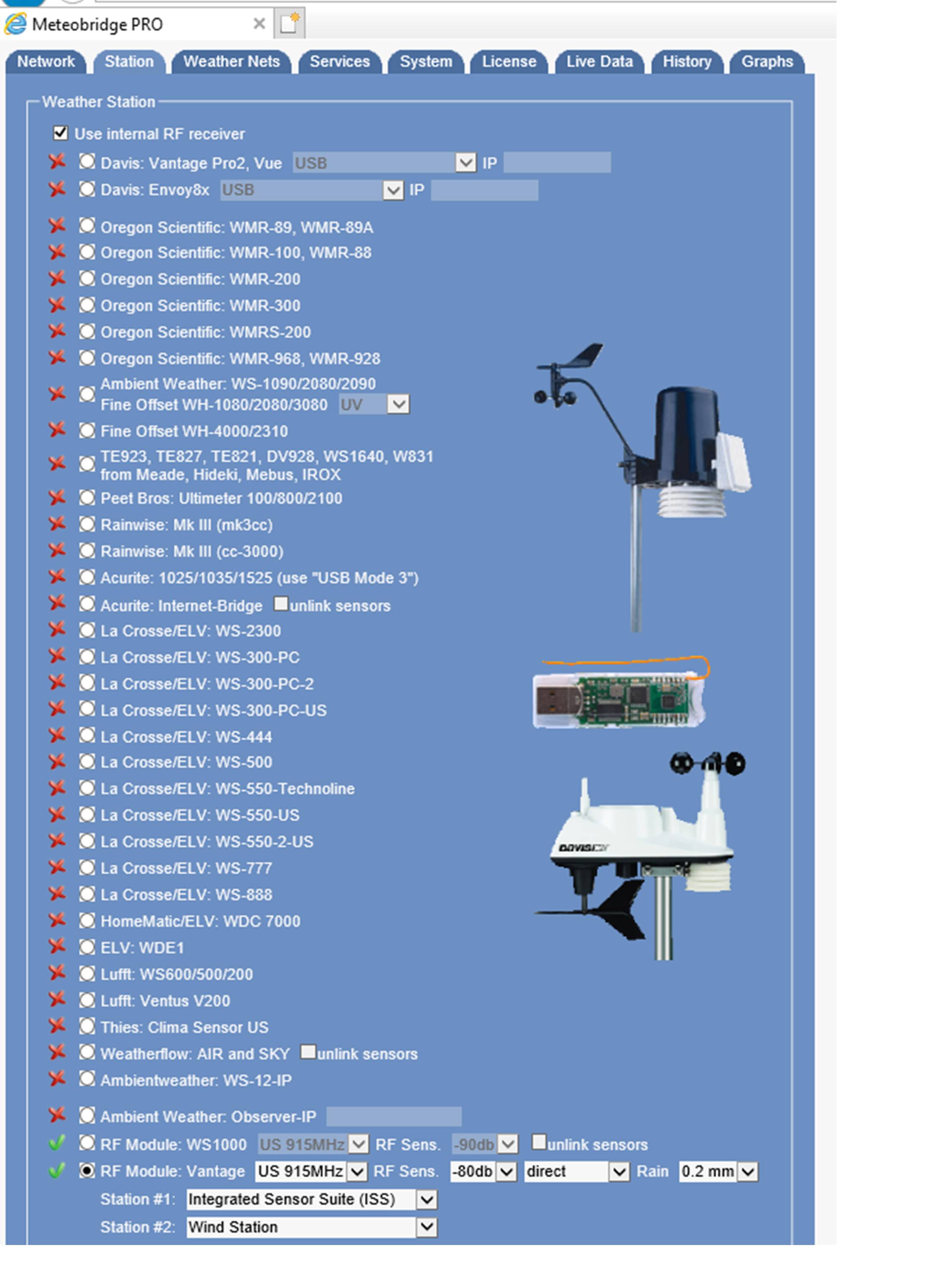

My brand new MB doesn't receive data from my weather station even if it next to the Davis consol that receives data nicely. I'm sure that there is some setting I have not got right, but I can't figure out which.
In the stations-tab, I have a mark in Use internal RF receiver at the top and a dot in RF module: Vantage at the bottom. Also the band has been chosen corresponding to the Vantage RF sens. is -70 db.
Station #1 is ISS and
Station #2 Wind station.
Any suggestions?
Re: New MB Pro not receiving data from Vantage
How far are your ISS and Wind Station away? MB won't have the range of the Davis station. Maybe try changing the RF Sens to -80db. Also check the setting after the RF Sen box is "Direct" and correct RF Freq is selected. The other thing to do would be to set your Davis Station to re-Transmit and let the MB Pro pick this up changing the "Direct" to "via Console"
Signal should be reasonable then? Have you checked your Freq matches your country settings EU, AU, US ? Now if all else fails can you post a screen shot of your Stations tab?

Post by JanMB »
Signal should be OK, but even if I move the MB right next to the ISS, I get no signal.
Frequency matches the Davis frequecy. I've even tried to change the MB to the other frequencies, with no result.
MB Station.jpg (353.29 KiB) Viewed 6360 times
Thanks for helping!
Ok couple of questions?
You don't appear to live in the US?
Is your Davis console/ISS from the US?
Where did you purchase your Davis gear?
If not the US then try setting to EU, save and reboot and give it 10 minutes

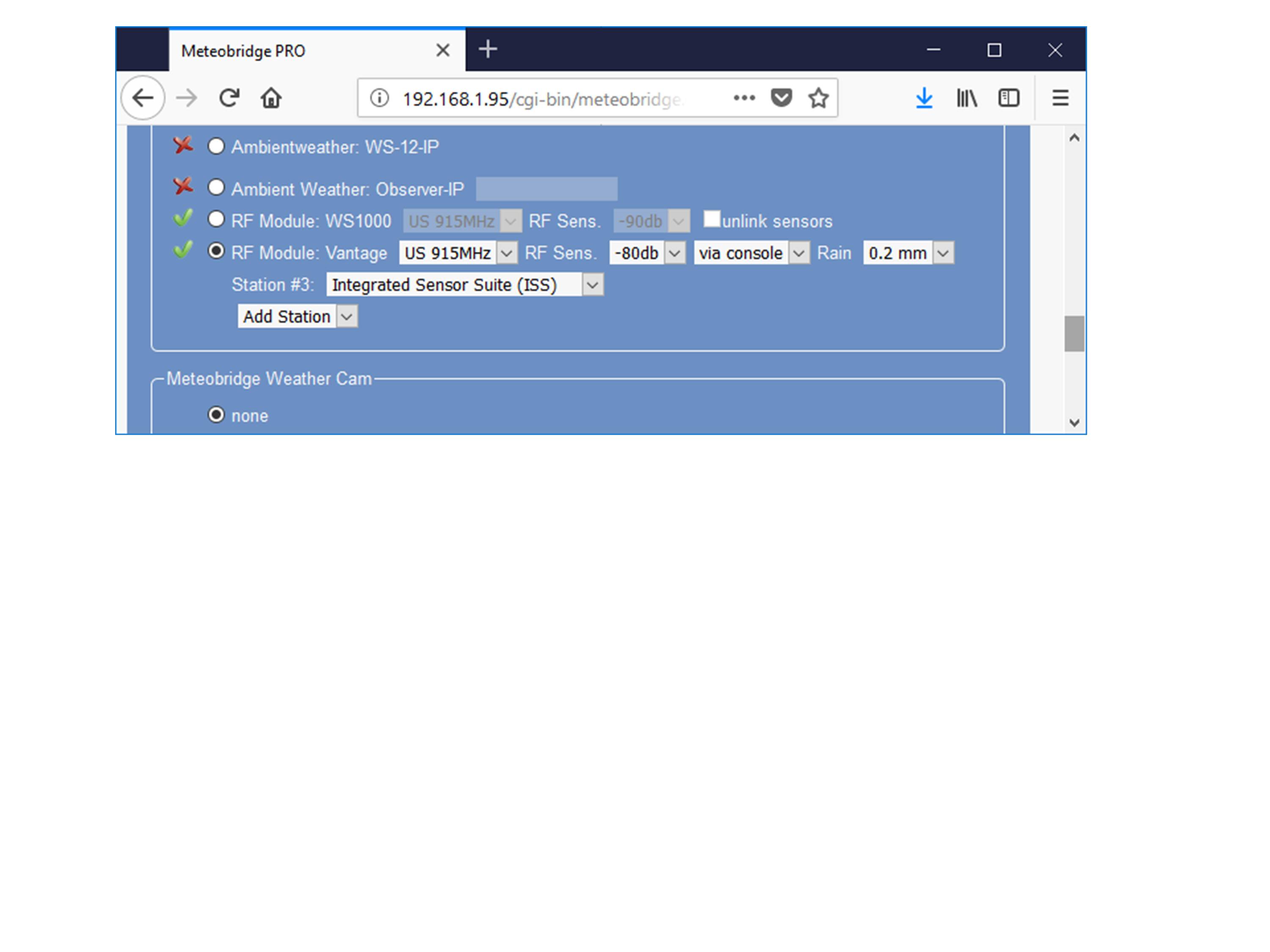

Post by JanMB »
I have set the console til retransmit as #3. I have then set the MBPro to recieve #3 and chosen ISS. Also I have changed the direct setting to Console. The MBPro has been placed next to the Davis console.
And now I'm seeing data being transmitted. I suppose that this means that the RF receiver of the MBPro is OK.
I have set the display of the MBPro to RF analysis - but the only displays are still two bars: '--'
It also seems that the Davis console only retransmits data from the ISS and not the Wind Station.
MB Station - data.jpg (489.7 KiB) Viewed 6354 times
Yes the RF is proven and the Davis console should re-transmit what data it is receiving, including wind. On the screen shot above the signal strength values (db) are cut off but at this short range the signal should be at least -45db or better?

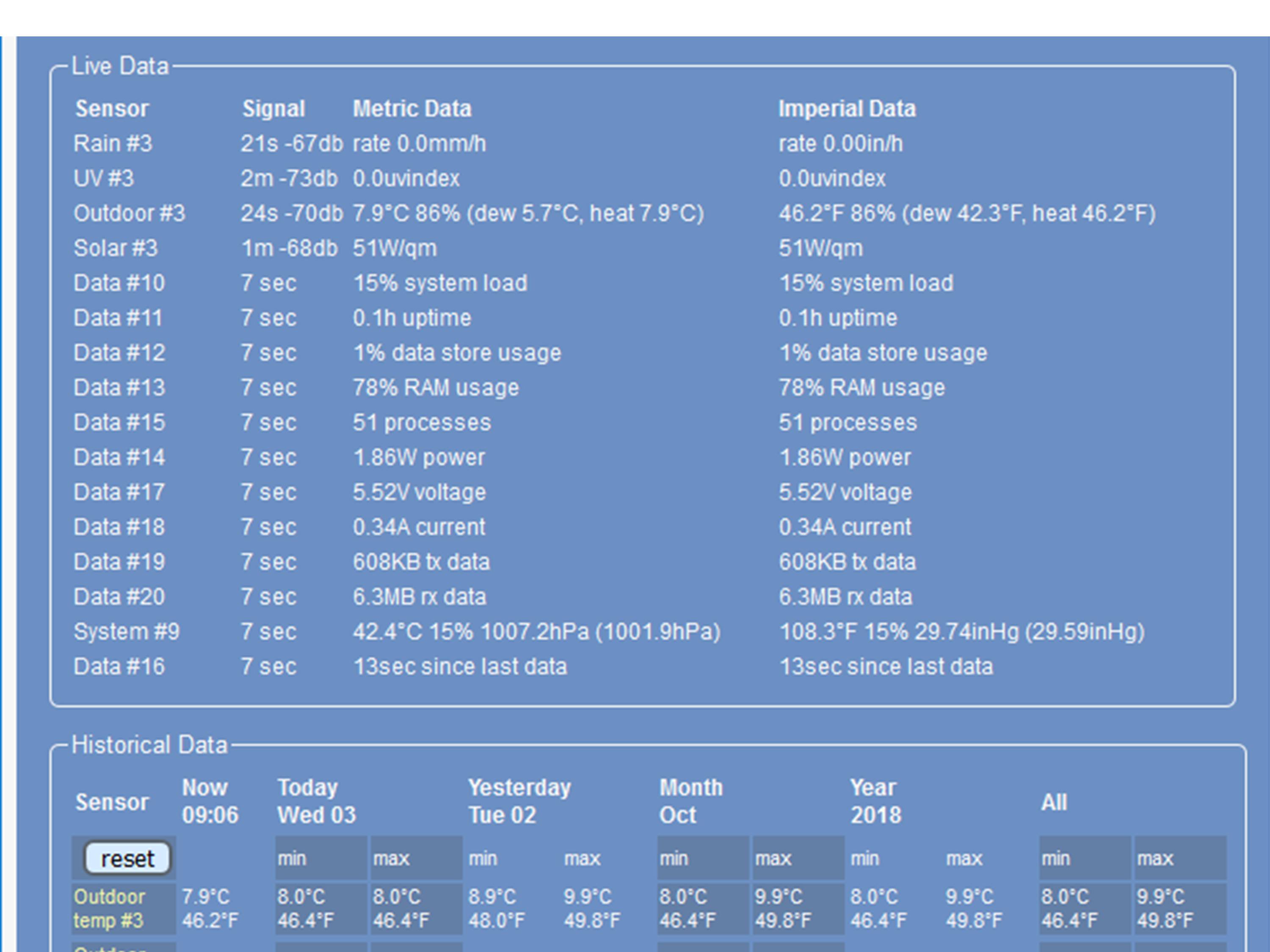

Post by JanMB »
I had set the Stations tab to show #1, 2 and 3. I have now chanched that so it only shows #3 and now I'm seeing data with no '#3'.
<Edit:> And the MBPro is showing the RF-strength in the panel.
The MBPro is less than 1 m from the Davis console and still the signal is weak.

Live Data:
MB Station - No3 data.jpg (346.44 KiB) Viewed 6321 times
