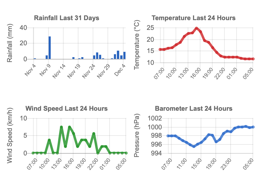

I also use the Fresh WDL where Flash is not available i.e. on Apple iPads.
My graphs have always looked odd in that the Temp and Baro always tail off to zero.

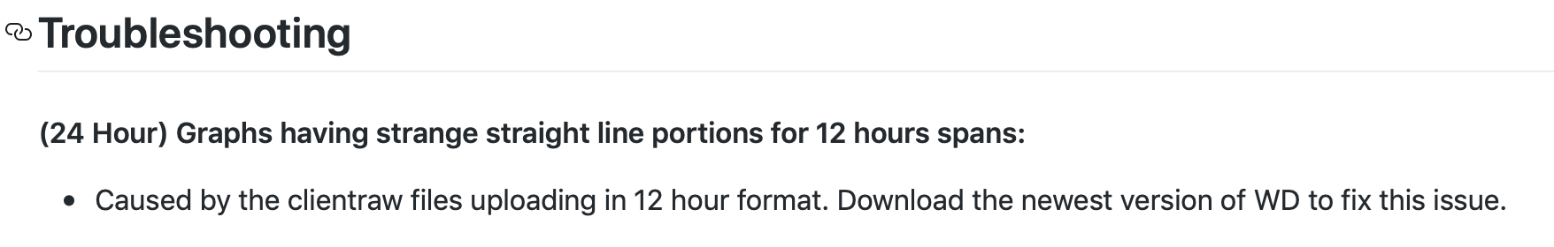

I attach the authors Graphs and my own. In the Troubleshoot it states there is a problem with client raw.txt from WD which of course we are no longer using. I don't understand the comment about 12 hour format though.
My version from Erith Weather is the one with the yellow background.

- Screenshot 2018-12-04 at 16.32.38.png (59.89 KiB) Viewed 91900 times
- Screenshot 2018-12-04 at 16.30.32.png (119.15 KiB) Viewed 91900 times
- Screenshot 2018-12-04 at 16.30.06.png (125.06 KiB) Viewed 91900 times
