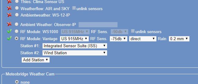

The VUE ISS is sitting inside on the same desk as the MB Pro. The VUE is used as a portable unit, and moves around with me, so I am first testing it inside to ensure that the unit connects properly before deploying it.
The RF Frequency (to the best of my knowledge) is the US 915MHz. I've ensured this is set on the MB as well (I've also tried other frequencies) The model number (6250M) indicates US - metric model.
The wind station is actually non-existent, and was an incorrect addition by myself. I am only trying to connect the VUE ISS.
I've also checked that the station is transmitting data on channel 1.

At 3 feet about the only things that will basically prevent a connection is the correct Freq & Tx ID combination, nothing else stands out at the moment

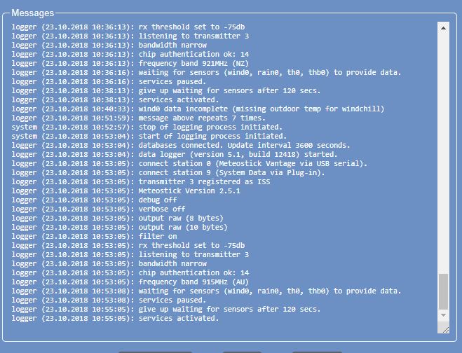

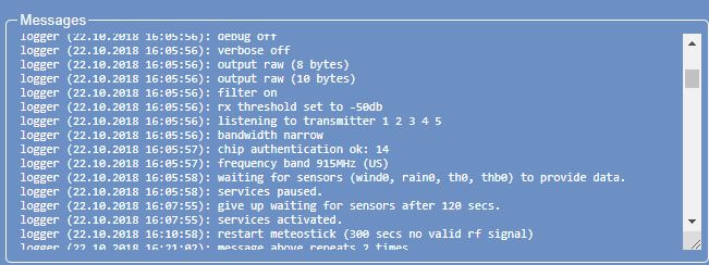

At this point, I've been waiting about 5-10min between setting changes, just in case it takes a bit of extra time to connect. The unit generally returns a "giving up waiting for sensors" message. I've been alternating through the settings, and on the AU band (915MHZ), the rf led on the top of the device started flashing red. I've attached a screenshot of the system log.
Edit:
I'd also like to note that I changed the transmitter to channel 3 in case there was any issues related to the weather station channel. (this is why the log now shows it's listening to transmitter 3)
Edit 2:
Looks like the station has now connected. Live data is updating!
Thanks for the help. It helped narrow down the issue. :)
