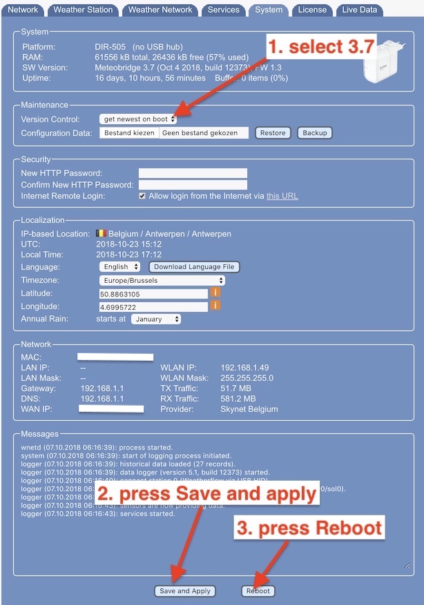

There is another topic about not connecting with the new version 3.8
Just to be sure:
Go to system tab
=> Version Control=> and select version 3.7 from the dropdown list
=> Save and reboot.
If version 3.7 fails also it is not a 3.8 problem

Thanks for the suggestions.
Unfortunately, I only have two options under "Version Control": "Stick to version 3.7" and "get newest on boot". Selecting "Stick to version 3.7" and rebooting does not cause a reversion to 3.7. A bit of the "you can't get there from here". Is there any other way to download software versions to the NANO - even assuming I could get the software image for the older versions?
Re: Nano - No data being received from Davis Vantage Pro2
1. After you select stick to 3.7RisaBaum wrote: Tue Oct 23, 2018 5:10 pm Thanks for the suggestions.
2. Did you press "Save and Apply" at the bottom?
3. BEFORE rebooting?
Otherwise the setting you just choose is not saved and after rebooting the latest "saved" setting is used.
- ver37.jpg (171.82 KiB) Viewed 4624 times

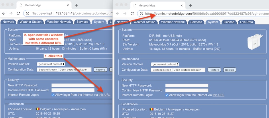

More info from admin at viewtopic.php?f=57&t=9885Also, what is supposed to happen when I check "Internet Remote Login" and click on "this url"? I get a black window with "Meteobridge" in the top right that shows briefly and then reverts back to the system tab. It doesn't matter which browser I use.
It is important to
1. check "Internet Remote Login" AND Press "Save and apply" at the bottom
2. after that "save and apply" you can click "this url"
It can take up to 5 minutes before the connection/tunnel is made, but the first time it can take up to an hour.
Succes,

About clicking the "this UIRL" you mentionedRisaBaum wrote: Tue Oct 23, 2018 6:20 pm ... shortened ...
2) It's been on the order of 18 hours since I first checked "Allow Login". I will have to figure out how to check to be sure that none of my equipment is blocking the creation of the ssh tunnel.
... shortened ...
I get a black window with "Meteobridge" in the top left that shows briefly and then reverts back to the system tab. It doesn't matter which browser I use.
That "black => system tab" should be in a new window or new tab!
So is there something other then the IP-address in the browsers address-line?
Exactly the same system tab as where you clicked "this URL" should be displayed, only the address-line should be different
- remote.jpg (145.02 KiB) Viewed 4619 times
