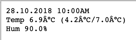

I have now moved on to creating and editing a mydata.http file as per the Wiki.
I have this experimental template as
[DD].[MM].[YYYY] [HH]:[mm][APM]
Temp [th0temp-act]°C ([th0temp-dmin]°C/[th0temp-dmax]°C)
Hum [th0hum-act]%
This is producing
Screenshot 2018-10-28 at 10.00.38.png (17.65 KiB) Viewed 3747 times
Not sure why I am seeing strange characters though.
I am using a MacBook Pro, editing the my data.http direct through the network with either TextEdit or TextWrangler (same result).
Is there a way of avoiding this (A^) thing?
Re: Experimenting with Sensor Strings
Some templates based on character sets will handle characters such as the ° symbol others will not and there appears quite a few different variables with this and in some respects can be affected by browser versions, email versions and the like.
In your example and being HTTP format then I would leave out the decimal symbol as it is rather erratic, if this was an email template then it would work fine.

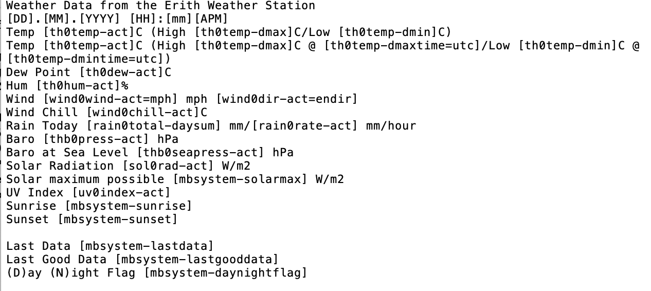

I sorted the strange character thing - thanks.
Can I ask some more questions please.
In my Mydata.http I have an output of
Weather Data from the Erith Weather Station
29.10.2018 11:03AM
Temp 8.5C (High 8.4C/Low 2.6C)
Temp 8.5C (High 8.4C @ 20181029105754/Low 2.6C @ 20181029064524)
Dew Point 3.9C
Hum 73.0%
Wind 0.0 mph NE
Wind Chill 8.5C
Rain Today 0.0 mm/0.0 mm/hour
Baro 1002.4 hPa
Baro at Sea Level 1008.1 hPa
Solar Radiation 397.0 W/m2
Solar maximum possible 343 W/m2
UV Index 1.2
Sunrise 06:48
Sunset 16:39
Last Data 6
Last Good Data 11
(D)ay (N)ight Flag D
At this stage some of these lines are just experimental to see what is possible.
On the 2nd Temp line I would like to see @ 10:29AM rather than the full date & time string - is that possible?
The Solar Max statement is obviously wrong somewhere but I am not too worried about that at present.
I attach my screenshot of the template
Screenshot 2018-10-29 at 11.05.02.png (116.65 KiB) Viewed 3729 times
Yes see the "Decimals" section near bottom of following link re formatting Date/Time etc
https://www.meteobridge.com/wiki/index.php/Templates
Re max possible solar for the day, do you have valid Latitude/Longitude set as well as pressure data available?
G4MHJ
Posts: 112
Post by G4MHJ »
Thanks for the Decimal hint.
Temp [th0temp-act]C (High [th0temp-dmax]C @ [th0temp-dmaxtime.ij:--=utc]:[th0temp-dmaxtime.kl:--=utc]/Low [th0temp-dmin]C @ [th0temp-dmintime.ij:--=utc]:[th0temp-dmintime.kl:--=utc])
This gives me
Temp 8.2C (High 8.3C @ 11:31/Low 4.6C @ 00:35).
Getting the idea a bit more now.
I have Lat/long set up and I checked via the url link on system tab. I might still have a baro error. My Console is giving 993.00mb (with no correction) and MBPro is showing 988.4mb. I guess the idea is to apply an offset to MB Pro due to internal heat.
Check your station Altitude on the Station tab>Local Settings before changing any corrections
