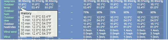

As you can see below, the data exists in the device and it seems to be OK.
temperature test.JPG (61.72 KiB) Viewed 5184 times

Historical data of the sensor it is OK, as you can see below.
history temp.jpg (46.09 KiB) Viewed 5173 times
Re: Export template: Total rain tags, not the value
Ok I think I can see what's going on here? Anything other than "avg" does not conform to the specifics of an export file. An export file is a line by line export based on and within a selected resolution, avg is applied by default to the full resolution period and the intent of an export file doesn't allow say a 1 minute resolution and trying to apply say a 60 minute average, won't work.
If you change all the avgxx to simply avg then you will populate the export file (no null data values) but of course the values will be identical.
