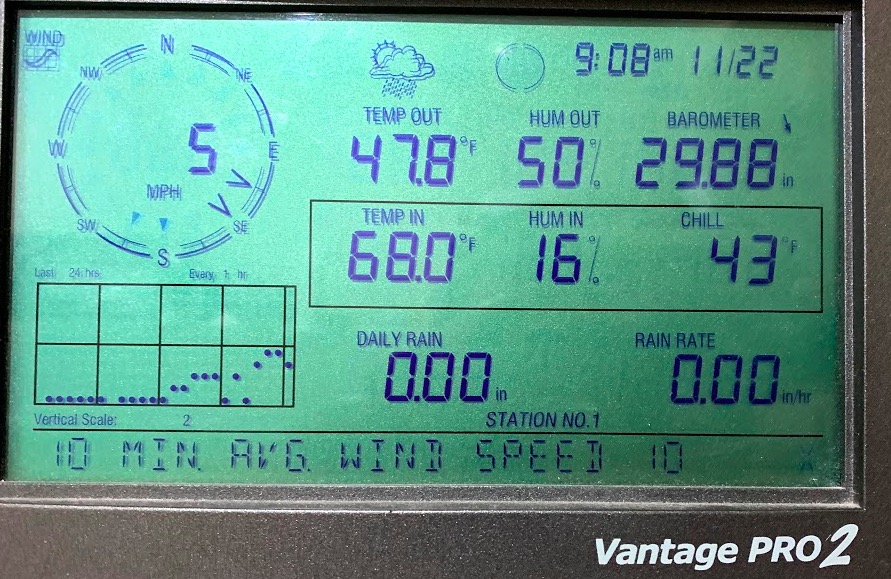

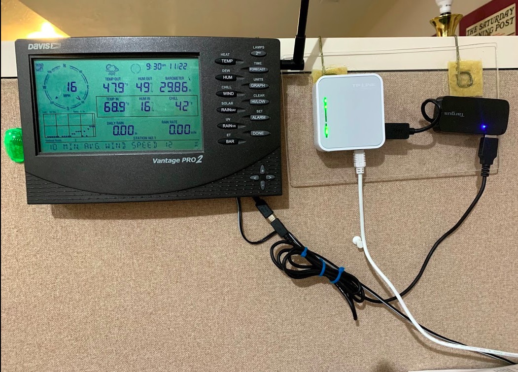

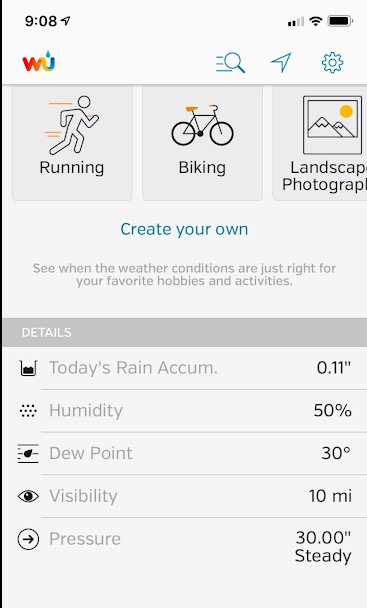

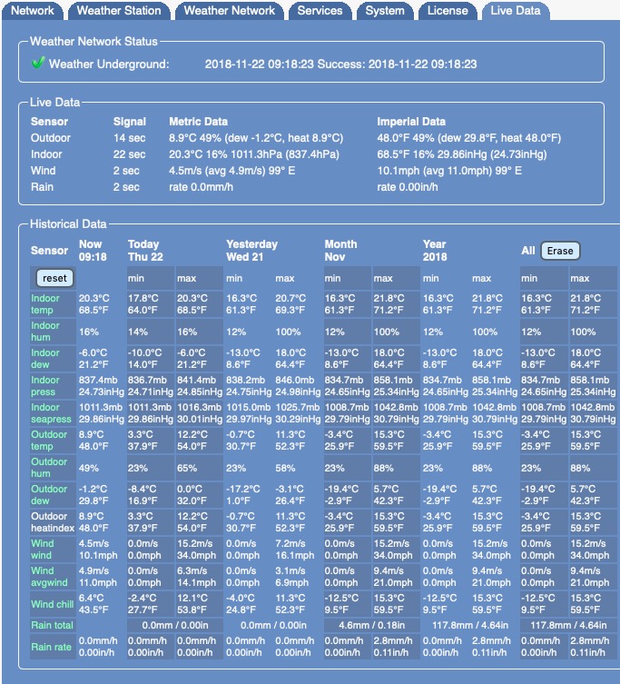

I've been waiting for another rain day, even though no rain is indicating on the PWS we have had a drizzle. Today WU shows .11" and VP2 shows .00", Meteobridge live data shows 0.00mm/0.00in. I'm connected to the VP2 from the Meteobridge through a USB hub. The Meteobridge is communicating to my router via WIFI.

Another piece of information: When I log into WU through Safari, the rain total is correct. Just on the WU APP on my iPhone is it in error. Today we have received .25" of rain and WU app shows 0.00" :(

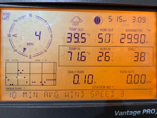

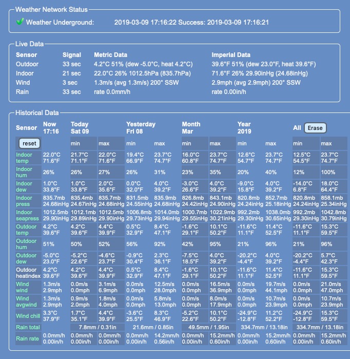

Today both the WU web page and my iPhone WU are the same. The VP2 shows .10" but the Meteobridge shows .31". As you can see, everything else seems to be correct.
