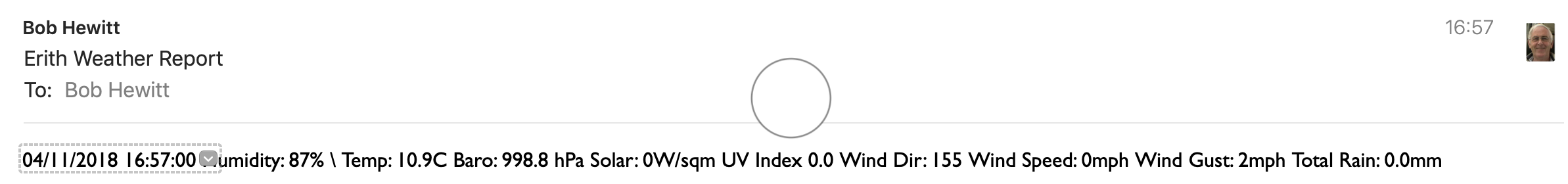

I have been looking (and learning) at the layout of the email template .mail and I am wondering if it is possible to add a line feed between each set of sensor strings in order to make it easier to read for a third party.

I am using a renamed copy of the borgerjr.mail giving the image attached.admin wrote: Sun Nov 04, 2018 6:50 pm Are you using a template file or is the content of the email directly specified on the subject/Body line in the event definition?
- Screenshot 2018-11-04 at 16.58.46.png (70.02 KiB) Viewed 3691 times

Are you using the Borerji.mail exactly as is or have to modified it?
Borerjr.mail should give you "Meteobridge weather report" as a subject line (do not see this in your example) and the body of the mail should appear like

Line formatting/spacing can be done by editing the template (added 1 & 2 <CR>) to achieve something like the following and most email clients will respect this but some think they are smart and remove "extra lines" but do allow a toggle to respect the intended formatting

I should have taken a copy first of borgervejr.mail before I tried to modify it. Is there a way of getting an original?
I noticed on the set-up dropdown I have a file _borgervejr.mail as well as borgervejr.mail but I am not sure what this is??
Here is my current file contents:
Erith Weather Report#\
[DD]/[MM]/[YYYY] [hh]:[mm]:00\r\n\
#if#{*[th0hum-act.0:-9999]!=-9999*}#then# Humidity: [th0hum-act.0:]%\r\n#else##fi#\
#if#{*[th0temp-act.0:-9999]!=-9999*}#then# Temp: [th0temp-act.1:]C\r\n#else##fi#\
#if#{*[thb0press-act.0:-9999]!=-9999*}#then# Baro: [thb0press-act.1:] hPa\r\n#else##fi#\
#if#{*[sol0rad-act.0:-9999]!=-9999*}#then# Solar: [sol0rad-act.0:]W/sqm\r\n#else##fi#\
#if#{*[uv0index-act.0:-9999]!=-9999*}#then# UV Index [uv0index-act.1:]\r\n#else##fi#\
#if#{*[wind0dir-act.0:-9999]!=-9999*}#then# Wind Dir: [wind0dir-act.0:]\r\n#else##fi#\
#if#{*[wind0avgwind-act.0:-9999]!=-9999*}#then# Wind Speed: [wind0avgwind-act.0:]mph\r\n#else##fi#\
#if#{*[wind0wind-max15.0:-9999]!=-9999*}#then# Wind Gust: [wind0wind-max15.0:]mph\r\n#else##fi#\
#if#{*[rain0total-sumday.0:-9999]!=-9999*}#then# Total Rain: [rain0total-sumday.1:]mm\r\n#else##fi#\
Giving an email with a Subject "Erith Weather Report"
04/11/2018 21:01:00 Humidity: 94% \ Temp: 9.2C Baro: 998.1 hPa Solar: 0W/sqm UV Index 0.0 Wind Dir: 146 Wind Speed: 0mph Wind Gust: 0mph Total Rain: 0.0mm
As you see the layout is not like your version.

Might depend on the editor you are using as those handle line ends differently.
Which one do you use? On which platform? Linux, Mac, Windows?
Can you please send the file to "info@samrtbedded.com" or give me remote access to your MB PRO?
