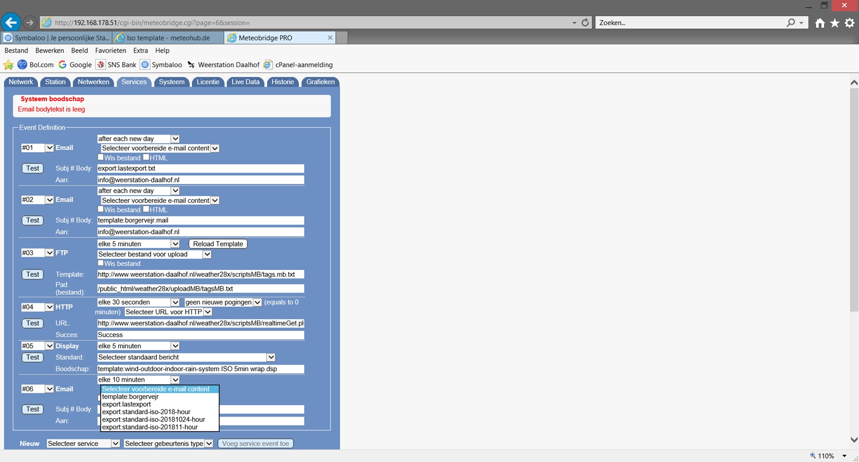

Re: Iso template
please see the attachment.
You said all .exp files will be shown in the dropdown menu.
I see only .txt files and the borgervejr is extension .mail
- MB Files.jpg (251.09 KiB) Viewed 4801 times
