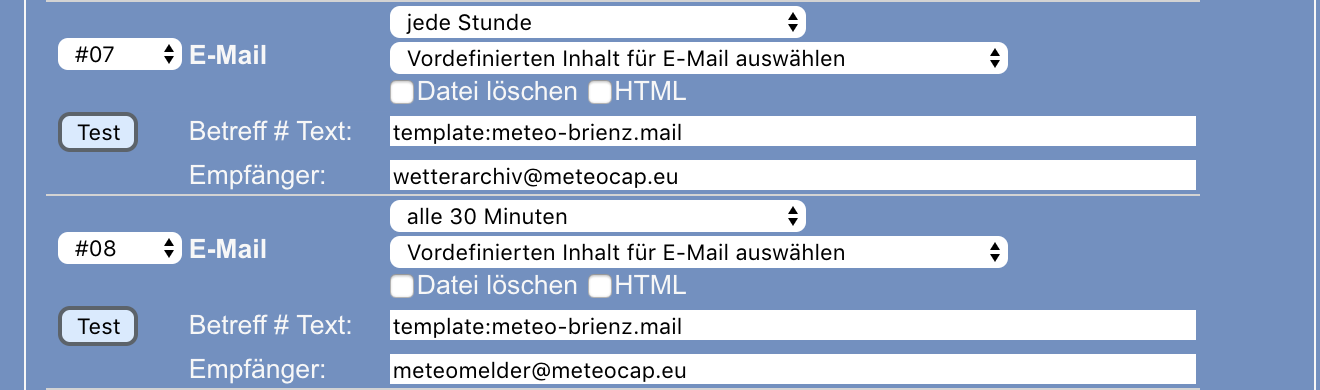

So apparently the emails do not go out.
Did not change anything. Must have happened last week.

webcam
Posts: 89
E-mail event does not work with version 3.8
Post by webcam »
Why is this file not being sent to me via email?

Re: Error messages
Is your email setup correctly on the bottom of the services page and when you click the <Test Mail> button does it work?
webcam
Posts: 89
Post by webcam »
Hello Mattk,
yes that's all right and works well.
For example, the own template borgerveji.mail works too. Unfortunately, my own meteo.mail not. With the content as above.

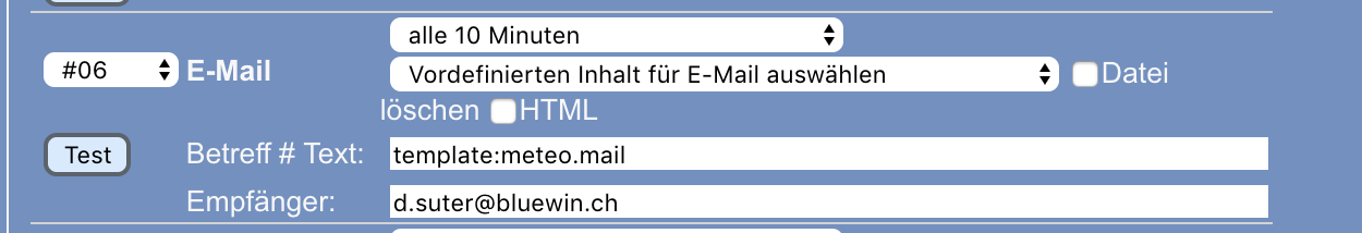

webcam
Posts: 89
Post by webcam »
I have now created a test event with my e-mail. Can test it that way?
First with version 3.6. Works wonderfully.
Then update to 3.8. And it does not work here.
Bildschirmfoto 2018-11-10 um 11.46.28.png (46.41 KiB) Viewed 5139 times

Re: E-mail event does not work with version 3.8
can you please send me your email template file? info(at)meteobridge.com

webcam
Posts: 89
Post by webcam »
Ok, with the newest version it works again.
