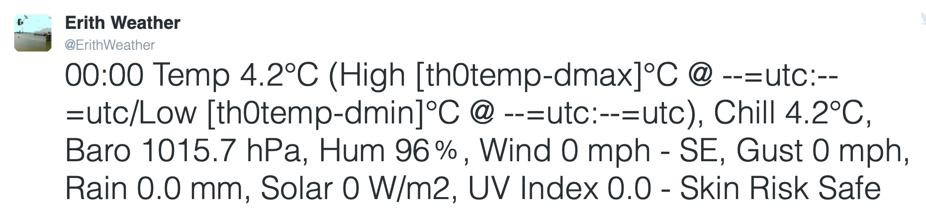

I have just noticed an anomaly on my Twitter Feed as shown below.
The Low temperature is not the lowest so I am wondering if I have the syntax correct or is the error a timing issue.
Here is the syntax "[hh]:[mm] Temp [th0temp-act=C.1:--]°C (High [th0temp-dmax]°C @ [th0temp-dmaxtime.ij:--=utc]:[th0temp-dmaxtime.kl:--=utc]/Low [th0temp-dmin]°C @ [th0temp-dmintime.ij:--=utc]:[th0temp-dmintime.kl:--=utc]),"

I don't see anything in the syntax that is an issue and tested that in a VP2/Envoy/Nano and it appears all good. The temp resolution of the VP2 is 0.1°C and accuracy +/- 0.5°C and the difference between 2.2 and 2.3 can be argued about all day, could be the timing, could be rounding at the raw level? Nothing much else comes to mind at this point
Re: Twitter Temperature Query
Syntax is wrong.
wrong
right:
This works for regular templates but I don't know if that also works for iterated export expressions. Give it a try.
wrong
[th0temp-dmaxtime.kl:--=utc]Code: Select all

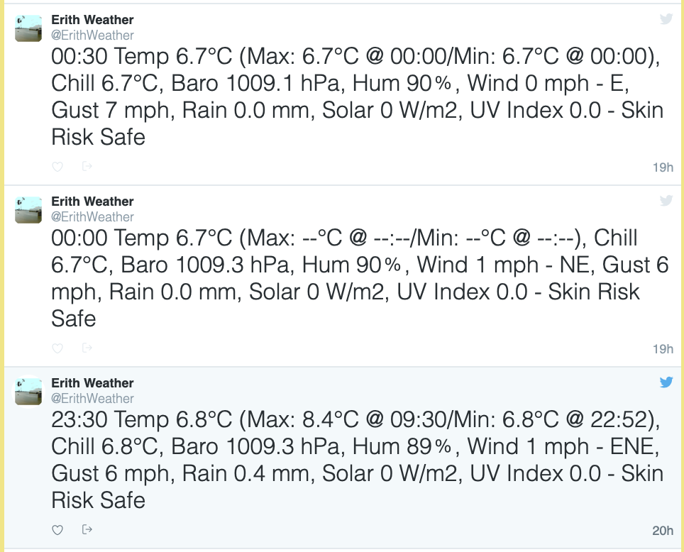

I have now had a chance to see the results of my syntax changes for my Twitter Feed.
At midnight, and only midnight I receive a Blank output. This doesn't really matter as far as I am concerned as the 00:30 feed corrects the error.
Maybe I still have something wrong or I have misunderstood the suggestions.
Syntax: [hh]:[mm] Temp [th0temp-act=C.1:--]°C (Max: [th0temp-dmax.1:--]°C @ [th0temp-dmaxtime=utc.ij:--]:[th0temp-dmaxtime=utc.kl:--]/Min: [th0temp-dmin.1:--]°C @ [th0temp-dmintime=utc.ij:--]:[th0temp-dmintime=utc.kl:--])
At precisely midnight it is today and generally no records for dmax type selectors to be meaningful.

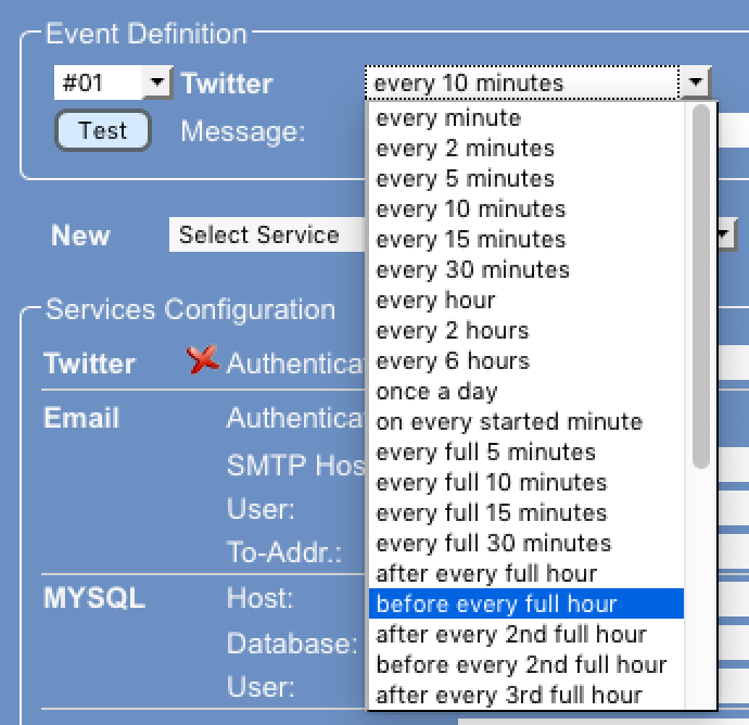

There are timing options for periodical tasks like hourly, daily, monthly, etc which trigger exactly before the flip is done and by that data that has shown up in the hour that has just passed is shown. For hours this timing option is named "before every full hour".

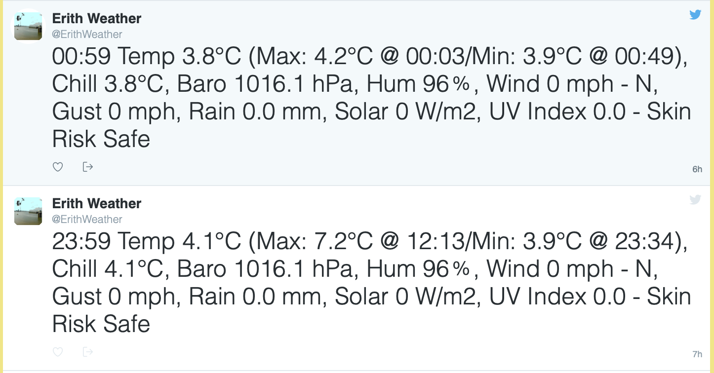

Thank you once again.
Here is the result of using your suggestion.
- Screenshot 2018-11-27 at 07.20.43.png (190.98 KiB) Viewed 4938 times
