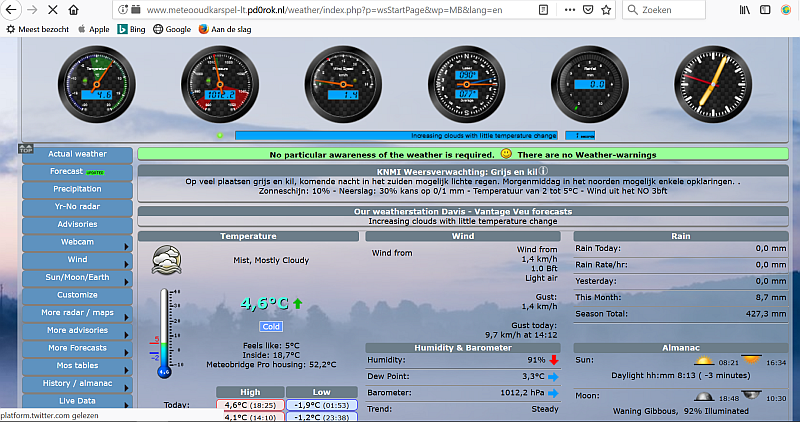

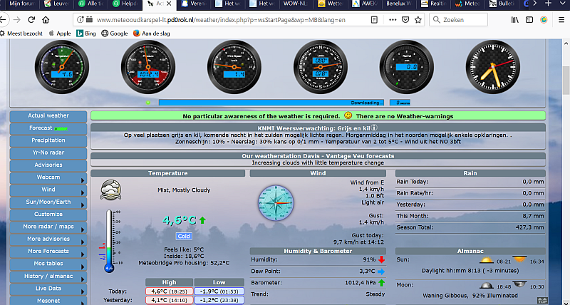

@ Boris
The wind direction in leters is no longer shown as a result of the update of 24 November 2018 Version 3.8 with leuven template version X.
Meteobridge 3.7 (Oct 21 2018, build 12410), FW 1.4 This version does not have the problem.
Wind direction in leters error in update of 24 November 2018 **solved**

Re: Wind direction in leters error in update of 24 November 2018
Thanks Boris for answer,
Now I have question, what must it be now, so [wind0dir-act=endir.5:--]
