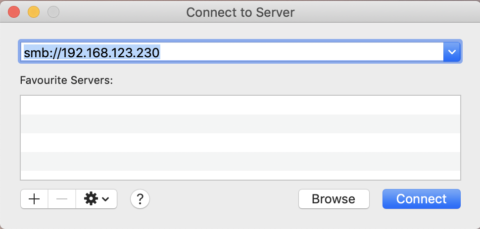

****** Mac ********
When you have a MAC just press "command-k" and this dialog will pop up. Let us assume that the IP of your PRO or NANO SD is 192.168.123.230 then the entry below is right.
Screenshot 2018-12-01 at 18.38.46.png (81.77 KiB) Viewed 12443 times
When you click onto "connect" you will be asked to login. Please use user "meteobridge" and password "meteobridge" to get connected. You can change the password on "System" tab of your Meteobridge. If you want to allow guest login which does not need any password you can set the corresponding mark on the "System" tab. Don't forget to press "save and apply" once you have made changes.

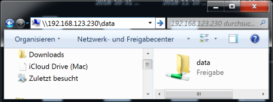

****** Windows *****
When you have a windows PC just open a windows explorer window and type in the network address to connect to. Let us assume that the IP of your PRO or NANO SD is 192.168.123.230 then the entry below is right.
Screenshot 2018-12-01 at 18.48.32.png (75.27 KiB) Viewed 12443 times
When asked for a user and password enter "meteobridge" as user and password. You can change the password on "System" tab of your Meteobridge. If you want to allow guest login which does not need any password you can set the corresponding mark on the "System" tab. Don't forget to press "save and apply" once you have made changes.
Re: How-To connect to Meteobridge PRO or NANO SD filesystem?
If you have a Windows 10 system, then SMB 1.x as used by Meteobridge is disabled by default.
Please enable like described here (https://www.ionos.com/digitalguide/serv ... ndows-smb/) and try again.
