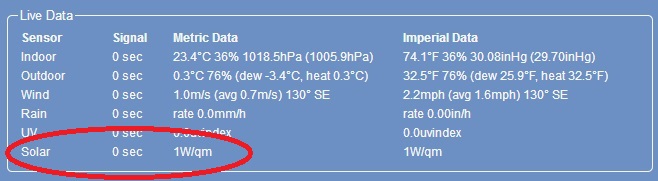

I have a WH4000 weather station.
The solar radiation value is always 1W at night. This is device error. It never measures 0 watt at night. Because of this problem AWEKAS disabled the solar radiation data.
Can you make correction options, such as Humidity Stretch on "Weather Station" screen?

I take it the console of you WH4000 reports 0 W/m2 but meteobridge reports 1W/m2
Re: WH4000 solar radiation at night problem
Newest update always maps "1" to "0" on solar radiation. These two number are anyway more in the range of guessing and if it makes AWEKAS happy to see a true Zero... so be it ;-)

Dear Admin!
Thank you!
It works.
