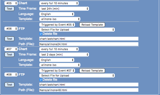

Boris,
Here is a screen shot of my settings. I have a folder on my webserver called Nano which is where I have the charts loaded into.
Thanks for helpin me out.
Paul
Paul

Are the same exact identical time frames conflicting?

I think the latest fix is now in place by Boris:
Version 3.8
released December 9, 2018
Version 3.8
- Meteobridge PRO & NANO: improves tests for WiFi connection issues and rebuilding WiFi connection if needed.
- Meteobridge PRO & NANO SD: shows data overview graphs on "History" tab in imperial units, when "imperial" flag is marked.
- Meteobridge PRO & NANO SD: improves handling of "lastchart.html" pointer, which now can handle generation and FTP upload of multiple charts at same point in time (as long as FTP uploads are directly triggered by a chart generation event).

When setting the "delete" mark, cascaded chart generation and upload events did not work. The just released update should support that. Please reboot the Meteobridge and give it a test drive.

Boris,
Thanks for fixing, works perfectly.
