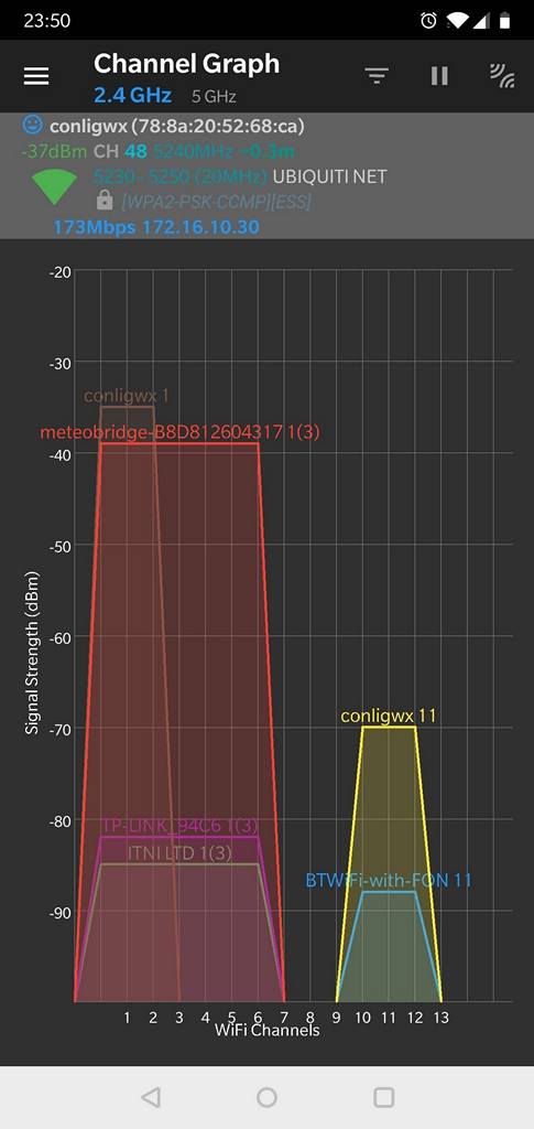

Just looking at a Wifi Analyzer.
Meteorbidge is transmitting on a 40Mhz band. is there anyway I can reduce this to a 20mhz along with its power output?
as you see Meteobridge Nano is crossing multiple bands with 40mhz and transmitting near max power too. I'd like to turn this off (factory reset would enable it again) or at least lower its power output and down to 20mhz band and be able to slect a channel if possible
this will be interfering with wifi throughput and possible loss of connection.

I am happy with the setup SSID showing, disconnected and password changed, this does serve a purpose and the last thing I would want to be doing is a default reset just to get to the initial setup page.

ok no worries, is there anyway of changing the ssid not to broadcast a 40mhz range, and use 20mhz instead?
Re: test5m warnings.
If that is to special importance for you, you can change the line "HT_BW=1" in file /etc/wireless/mt7628/mt7628.dat" to "HT_BW=0". But be aware that your NANO will render useless when you mess up this file.
