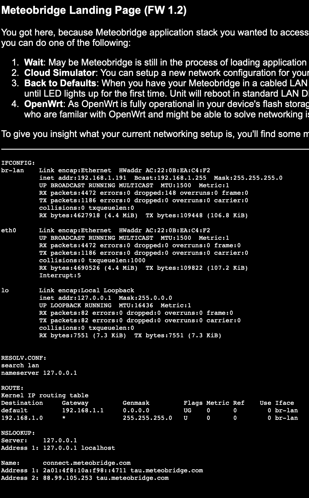

After several years of use, as of last night my ASUS WL-330N3G will not load the application stack from the Internet.
I have tried waiting, pressing the button to set defaults, setting defaults in OpenWrt, reflashing meteobridge-wl-330n3g-v1.2.sys using TFTP, then finally loading a configuration file from the cloud simulator. Of course all the while the WL-330N3G is actually online and pingable. I’ve run out of troubleshooting steps.
Any help would be appreciated!

I wouldn't have attacked the defaults, OpenWrt, reflashing or any major surgery until the simple and common things have been exhausted.
Is the Internet connection all good? When was the last time the unit was rebooted, has any network/router changes been made since? When you say "the WL-330N3G is actually online and pingable" is this on the LAN side or WAN?

Having the same issue - just rebooted a few minutes ago to pickup the new code. Running same Asus HW as well.
Seeing lots of dropped packets as well.

No changes. Internal and external Internet access is all normal. The unit was last rebooted about a week ago. It was still functioning normally on my WiFi when the problem began. After moving to Ethernet and reflashing, Meteobridge is still pingable. It just won't load the application stack from the Internet.Mattk wrote: Fri Dec 21, 2018 8:07 am I wouldn't have attacked the defaults, OpenWrt, reflashing or any major surgery until the simple and common things have been exhausted.
Apparently Meteobridge version 3.8 was released on 12/20, which seems more than coincidental. Considering tjones is having the same problem, I suspect this latest release was pushed to our barely supported WL-330N3G's and killed them.

I can confirm it's not a hardware issue on my end - network is fine, can ping the tau server and not dropping packets there on all packet sizes.
Something's up with the new code it's trying to download - dropping around 12% of received packets per the landing page and they are not CRC or local errors - something inside the packets is corrupt.
Re: ASUS WL-330N3G Not Loading
It was an error in the build chain. Please try again, just released image should have this fixed again.
