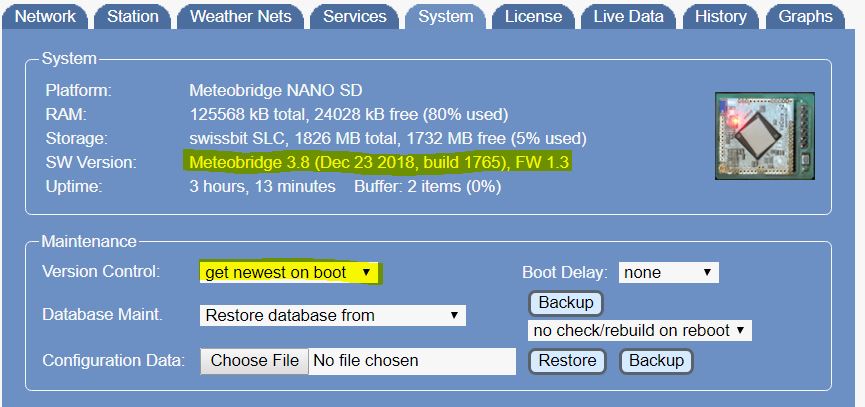

ConligWX
Posts: 329
Re: Setup lost in weather34 after MB restart
Post by ConligWX »
fdmarder1 wrote: Sun Dec 23, 2018 8:11 pm Hi,
I use the internal weather34 display.
Where could I see if a SW-update was done ?
Regards Fdmarder
in the system tab.

Thx Simon,
I update now to the newest version 1765
Sure Mattk I hit [Save] , otherwise I cant see my change seetings.
