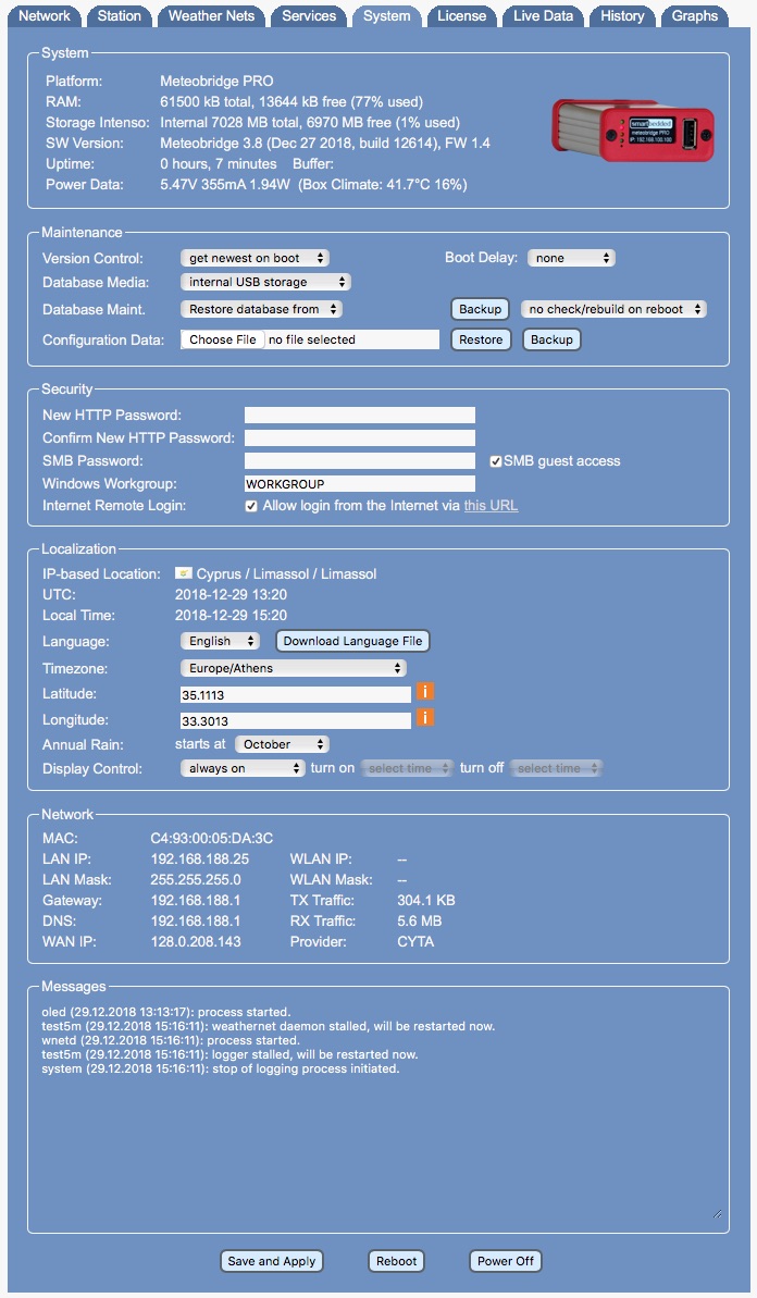

Hi all,
My MB Pro has suddenly stopped working properly. It does not reboot through the browser interface, and when I unplug it from the power and plug it back in again after some time, it boots but has near-zero functionality. I am attaching 2 screenshots.
When I connect to the box through SMB, I can see the "data" directory, but the directory is empty.
Does this sound like a failure of the flash storage?

2 years old then I might suspect the internal (Intenso) especially as it appears your MB is rather busy? You could test this by adding an external USB stick to the front panel (assuming it's not populated with another device?) and setting the database media: drop down to "USB stick on front panel" and reboot
If front USB port is taken then use the rear micro and adapter tail and set database media accordingly

Thank you very much Mattk!! After adding an external USB stick to the front panel and rebooting, the MB Pro is back to full functionality! Thus, the problem is with the internal storage. Is it easy/advisable to open the MB Pro and replace the internal storage? If yes, are there any particular requirements pertaining to the type/size/etc. of the new internal storage?
