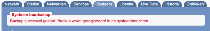

My MB pro reboots every time it receives a backup command. I activated the backup script on the tab system; every time the MB pro does a reboot and not a backup.
Schermafbeelding 2019-01-14 om 09.13.14.jpg (29.58 KiB) Viewed 6703 times

Even with a manual backup, the MB does a reboot and not a backup.
How is this possible? :evil:

Usually a back-up does not work. When I make a backup, after about 1 minute a restart will take place and no backup will be made on usb-stick.
Sometimes a backup succeeds, usually a restart occurs. So it is difficult for me te make a backup!
Am I doing something wrong?
