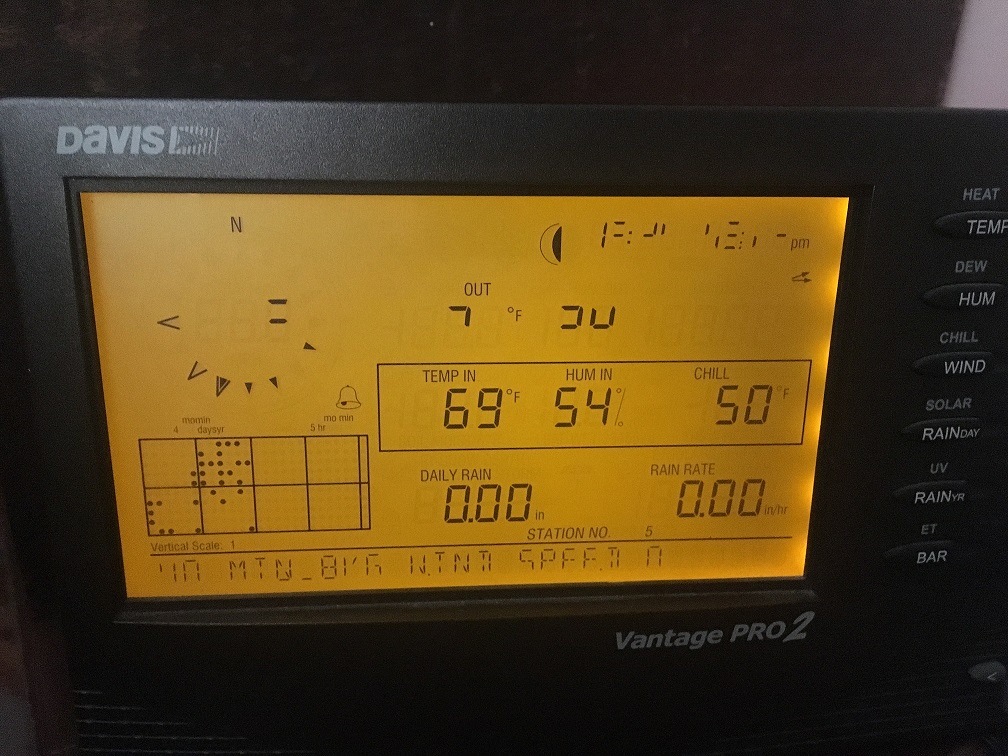

Has anyone ever run into an issue after plugging in the nano to a Davis Vantage Pro 2 console then the screen does not display correctly. Trying to figure out whether this is a console issue or something to do with the nano. We have tried a full restart of the console and tried re-seating the nano. Any suggestions?

Did you pull the power and the batteries first. Then plug in the nano and then power up the console?
Re: Vantage Pro 2 Console Display
Looks like the console language has been switched to Klingon ;-) Never saw that.
If replugging the NANO and making console powerless for a few mins und starting up again does not help, go for a NANO replacement.
