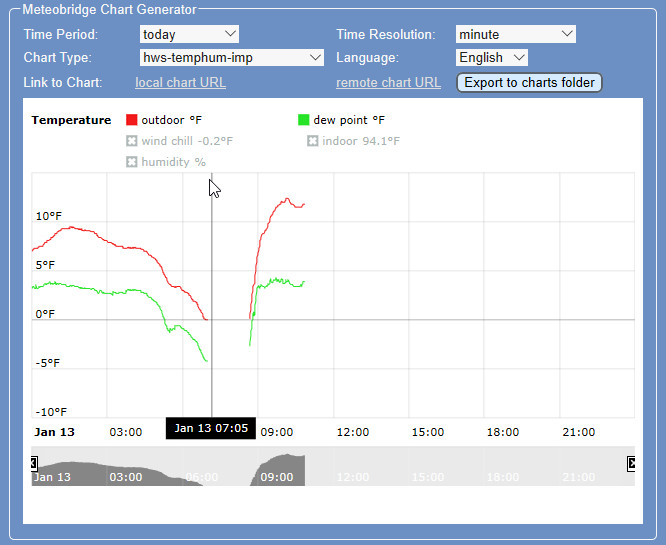

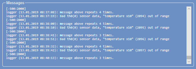

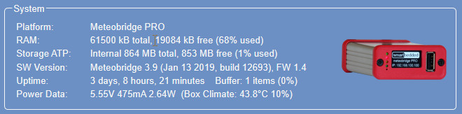

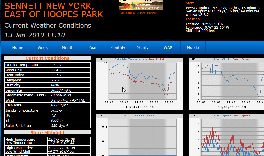

I am a newbie to the Meteobridge and just recently received my unit. I am testing my Vantage Pro 2 ISS with the Meteobridge Pro RED and the original console with USB to a PC. I have noticed that when I received temperatures below Zero that I get an error in the logs complaining that the temperature is out of range and seems to leave that data out of the graphs. The Console that is connected to USB has no concerns and reads the data properly. I am using software 3.9 Jan 6th but have recently rebooted and are now on the newest version.
Error when temperature is below Zero
Missing data in graph

Data from console no missing data

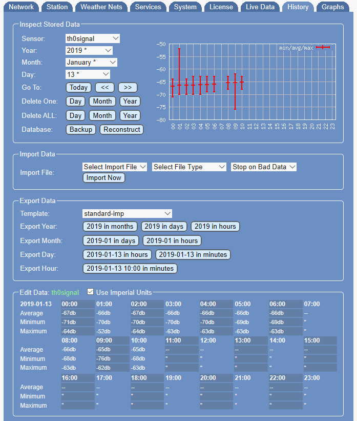

The signal strength seems OK as I have a Yagi antenna and only ~80' to the ISS thru a window and block wall. I am going to move outside in the summer to bring the signal strength up.
signal strength
signal strength

I updated to the Version 3.9 released January 17, 2019
