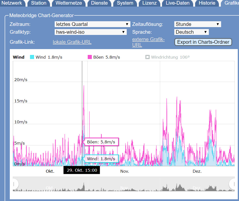

on my graphic tab i can choose "last quarter" / "letztes Quartal" an I choose the "hws-wind-iso" template and it shows the correct data:

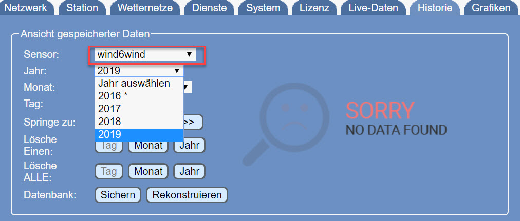

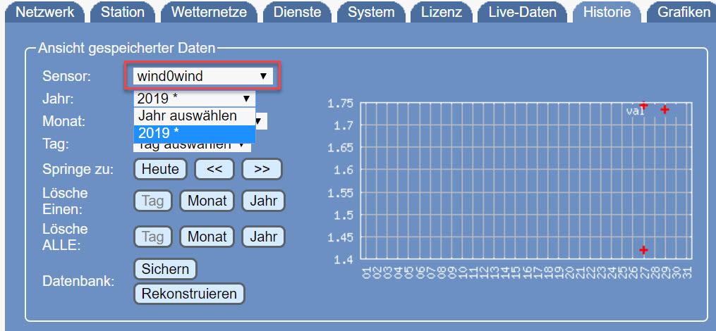

But when i choose the tab "history" --> and sensor: "wind0wind" --> I only can see the year 2019 in the Year-dropdown:
And the most curios thing is: that i have a "win6wind" sensor in the dropdown-menu, which makes no sense. But whe i choose the "win6wind" sensor in the history tab, i can see the years back until 2016 in the dropdown but no data, except a few in 2016 , the timeframe till 2016 is correct, but of the wrong sensor. I dont have multiple wind sensors.
I have allready tried to recontsruct the Database with the "reconstruct" Tab, but nothing has changed. And there where some errors in the log:
I tried to attach a textfile here with the Log-informations but it seems that does not work for me:
so forgive me, I'll paste the line inside this post:
many thanks for any help
marco
database (27.01.2019 05:23:53): database sync done (52 tables, 543/1758 writes).
database (27.01.2019 06:54:33): database reconstruction initiated (52 sensors).
database (27.01.2019 06:55:08): failed with step 6 on data10num_hour (after 0 retries in 2ms): database disk image is malformed (11)
database (27.01.2019 06:55:08): rollback on reconstruct forced (3) (hour): data10num
database (27.01.2019 06:55:48): reconstruction for sensor "data11num" done in 37 secs.
database (27.01.2019 06:56:24): failed with step 3 on data12num_hour (after 0 retries in 1ms): string or blob too big (18)
database (27.01.2019 06:56:24): rollback on reconstruct forced (3) (hour): data12num
database (27.01.2019 06:57:04): reconstruction for sensor "data13num" done in 36 secs.
database (27.01.2019 06:57:44): reconstruction for sensor "data15num" done in 37 secs.
database (27.01.2019 06:58:20): failed with step 0 on data16num_hour (after 0 retries in 1ms): database disk image is malformed (11)
database (27.01.2019 06:58:20): rollback on reconstruct forced (3) (hour): data16num
database (27.01.2019 06:59:00): reconstruction for sensor "data14num" done in 37 secs.
database (27.01.2019 06:59:41): reconstruction for sensor "data17num" done in 38 secs.
database (27.01.2019 07:00:20): reconstruction for sensor "data18num" done in 36 secs.
database (27.01.2019 07:00:54): failed with step 9 on data19num_hour (after 0 retries in 1ms): database disk image is malformed (11)
database (27.01.2019 07:00:54): rollback on reconstruct forced (3) (hour): data19num
database (27.01.2019 07:01:29): failed with step 10 on data20num_hour (after 0 retries in 1ms): database disk image is malformed (11)
database (27.01.2019 07:01:29): rollback on reconstruct forced (3) (hour): data20num
database (27.01.2019 07:02:06): reconstruction for sensor "thb9temp" done in 35 secs.
database (27.01.2019 07:02:39): failed with step 14 on thb9hum_hour (after 0 retries in 1ms): database disk image is malformed (11)
database (27.01.2019 07:02:39): rollback on reconstruct forced (3) (hour): thb9hum
database (27.01.2019 07:03:13): failed with step 16 on thb9dew_hour (after 0 retries in 1ms): database disk image is malformed (11)
database (27.01.2019 07:03:13): rollback on reconstruct forced (3) (hour): thb9dew
database (27.01.2019 07:03:52): reconstruction for sensor "thb9press" done in 36 secs.
database (27.01.2019 07:04:29): reconstruction for sensor "thb9seapress" done in 35 secs.
database (27.01.2019 07:05:08): reconstruction for sensor "thb9lowbat" done in 35 secs.
database (27.01.2019 07:05:42): failed with step 9 on wind0dir_hour (after 0 retries in 1ms): database disk image is malformed (11)
database (27.01.2019 07:05:42): rollback on reconstruct forced (3) (hour): wind0dir
database (27.01.2019 07:06:17): failed with step 0 on wind0wind_hour (after 0 retries in 1ms): database disk image is malformed (11)
database (27.01.2019 07:06:17): rollback on reconstruct forced (3) (hour): wind0wind
database (27.01.2019 07:06:50): failed with step 7 on wind0avgwind_hour (after 0 retries in 1ms): database disk image is malformed (11)
database (27.01.2019 07:06:50): rollback on reconstruct forced (3) (hour): wind0avgwind
database (27.01.2019 07:07:26): failed with step 3 on wind0chill_hour (after 0 retries in 1ms): database disk image is malformed (11)
database (27.01.2019 07:07:26): rollback on reconstruct forced (3) (hour): wind0chill
database (27.01.2019 07:08:04): reconstruction for sensor "wind0lowbat" done in 36 secs.
database (27.01.2019 07:08:08): reconstruction for sensor "wind0signal" done in 1 secs.
database (27.01.2019 07:08:42): failed with step 10 on rain0rate_hour (after 0 retries in 1ms): database disk image is malformed (11)
database (27.01.2019 07:08:42): rollback on reconstruct forced (3) (hour): rain0rate
database (27.01.2019 07:09:22): reconstruction for sensor "rain0total" done in 37 secs.
database (27.01.2019 07:09:56): failed with step 22 on rain0lowbat_hour (after 0 retries in 1ms): database disk image is malformed (11)
database (27.01.2019 07:09:56): rollback on reconstruct forced (3) (hour): rain0lowbat
database (27.01.2019 07:09:58): reconstruction for sensor "rain0signal" done in 0 secs.
database (27.01.2019 07:10:38): reconstruction for sensor "sol0rad" done in 37 secs.
database (27.01.2019 07:11:13): failed with step 24 on sol0lowbat_hour (after 0 retries in 1ms): database disk image is malformed (11)
database (27.01.2019 07:11:13): rollback on reconstruct forced (3) (hour): sol0lowbat
database (27.01.2019 07:11:16): reconstruction for sensor "sol0signal" done in 0 secs.
database (27.01.2019 07:11:54): reconstruction for sensor "th0temp" done in 35 secs.
database (27.01.2019 07:12:33): reconstruction for sensor "th0hum" done in 36 secs.
database (27.01.2019 07:13:13): reconstruction for sensor "th0dew" done in 36 secs.
database (27.01.2019 07:13:52): reconstruction for sensor "th0heatindex" done in 36 secs.
database (27.01.2019 07:14:27): failed with step 23 on th0lowbat_hour (after 0 retries in 1ms): database disk image is malformed (11)
database (27.01.2019 07:14:27): rollback on reconstruct forced (3) (hour): th0lowbat
database (27.01.2019 07:14:30): reconstruction for sensor "th0signal" done in 0 secs.
database (27.01.2019 07:15:10): reconstruction for sensor "thb0temp" done in 37 secs.
database (27.01.2019 07:15:45): failed with step 22 on thb0hum_hour (after 0 retries in 1ms): database disk image is malformed (11)
database (27.01.2019 07:15:45): rollback on reconstruct forced (3) (hour): thb0hum
database (27.01.2019 07:16:24): reconstruction for sensor "thb0dew" done in 36 secs.
database (27.01.2019 07:17:04): reconstruction for sensor "thb0press" done in 38 secs.
database (27.01.2019 07:17:43): reconstruction for sensor "thb0seapress" done in 37 secs.
database (27.01.2019 07:18:22): reconstruction for sensor "thb0lowbat" done in 36 secs.
database (27.01.2019 07:18:25): reconstruction for sensor "thb0signal" done in 0 secs.
database (27.01.2019 07:18:28): reconstruction for sensor "wind6dir" done in 0 secs.
database (27.01.2019 07:18:32): reconstruction for sensor "wind6wind" done in 0 secs.
database (27.01.2019 07:18:35): reconstruction for sensor "wind6avgwind" done in 0 secs.
database (27.01.2019 07:18:38): reconstruction for sensor "wind6chill" done in 1 secs.
database (27.01.2019 07:18:40): reconstruction for sensor "wind6lowbat" done in 0 secs.
database (27.01.2019 07:18:43): reconstruction for sensor "wind6signal" done in 0 secs.
database (27.01.2019 07:19:23): reconstruction for sensor "sol0evo" done in 37 secs.
database (27.01.2019 07:19:57): reconstruction for sensor "uv0index" done in 31 secs.
database (27.01.2019 07:20:32): reconstruction for sensor "uv0lowbat" done in 32 secs.
database (27.01.2019 07:20:33): database reconstruction done (26800 writes).
