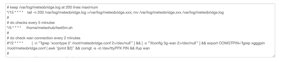

I mean, looking at Advanced under Network (where it goes to OpenWRT interface), I see two possible options.
Comment out the cron task for the test5m (not sure if that will work), or possibly edit the lan interface since it's the one attached to the meteobridge ssid...
