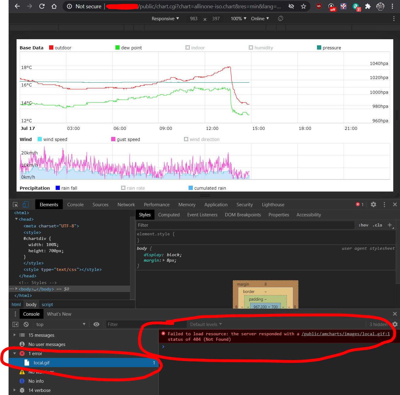

Ok I was inspecting my chart file created by Meteobridge nano.
I seen this error as a missing file: /public/amcharts/images/local.gif
the file url within the chart however tries to link itself to my domain:
can we please get this fixed.

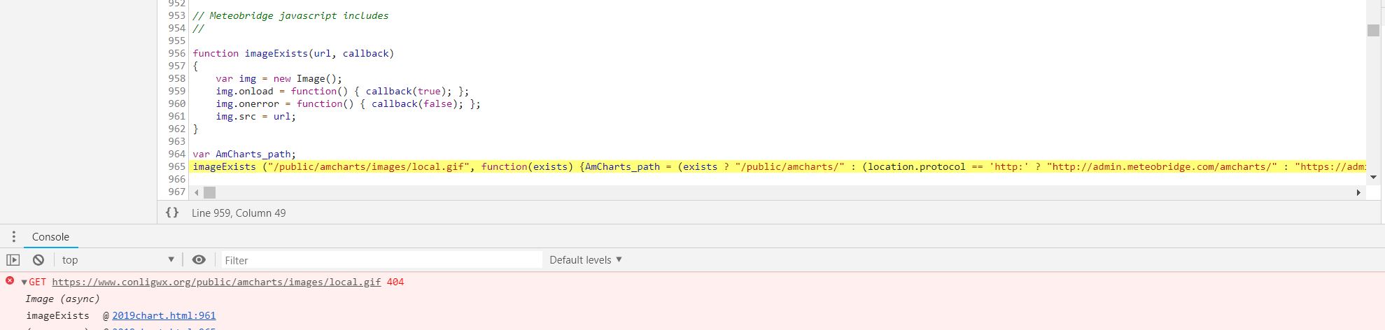

here is a chart on my server. Please use the "inspect" on google chrome
its also looking for another image:
https://www.conligwx.org/public/amchart ... undBig.svg
and content includes http and https links so it warns:
Mixed Content: The page at '<URL>' was loaded over HTTPS, but requested an insecure image '<URL>'. This content should also be served over HTTPS.

I have exactly the same problem in Graphs tab in meteobridge PRO.
Although it is a slight issue, it is appreciated that it can be fixed for the next release.

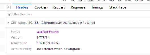

Running latest Meteobridge NANO SD
same issue
2020-07-17 10_23_44-Clipboard.png (7.59 KiB) Viewed 2583 times

the missing file should be here:
/www/public/amcharts/images/local.gif
I am now on: Meteobridge 4.4 (Jul 13 2020, build 3167), FW 1.3
screenshot shows error. just goto Graphs Tab. today allinone.iso, click on Local Chart URL.
then inspect the webpage that loads. Missing file.
I also exported the chart to my webserver. local.gif is missing there too.
