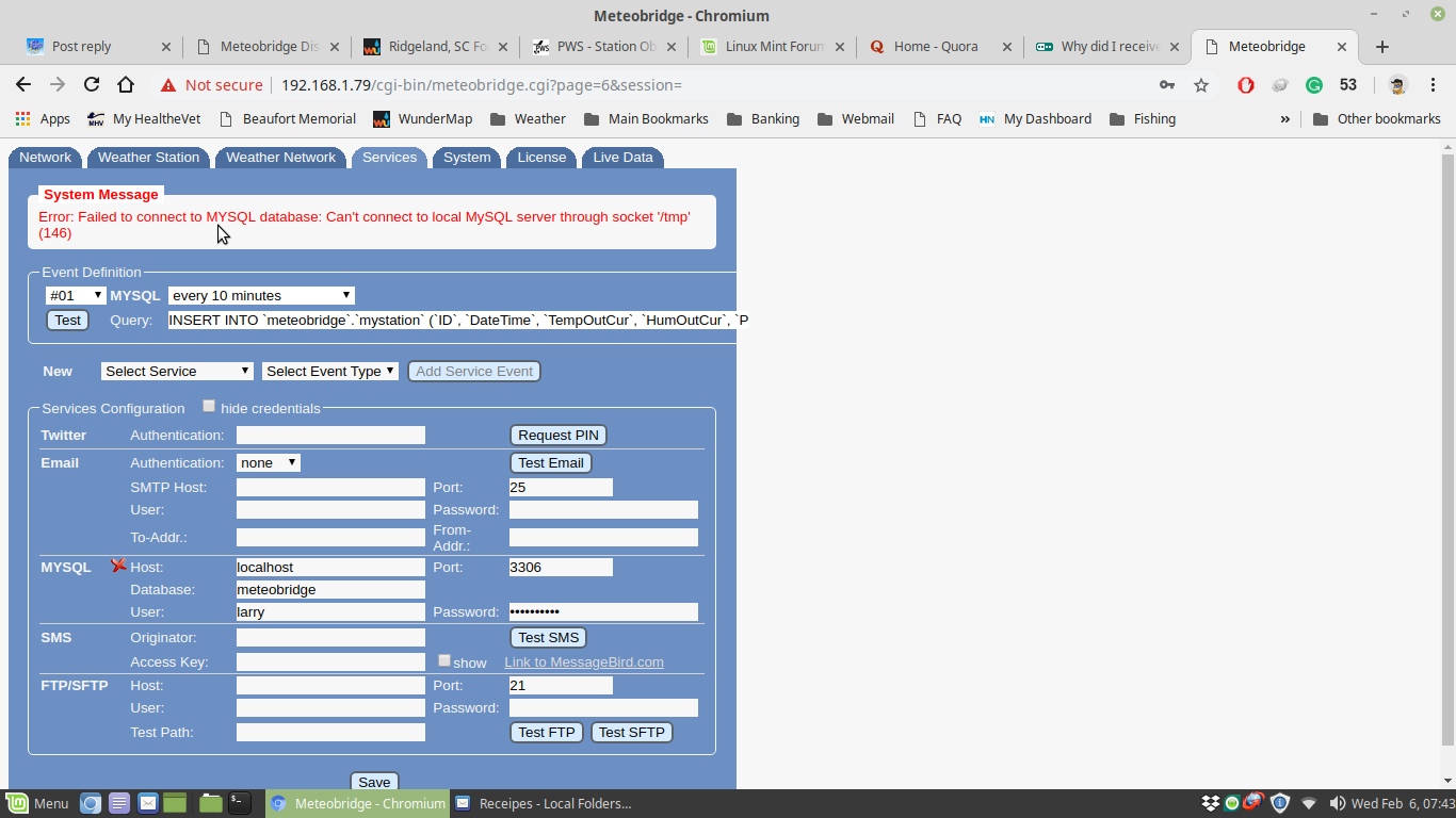

I've been trying to get a MySQL service running on my Linux machine. Both the database and connection to Meteobridge are on the same machine. I'm getting the following error: Failed to connect to MYSQL database: Can't connect to local MySQL server through socket '/tmp' (146). I've double-checked mysql.cnf and mysql.conf and they both point to /var/run/mysqld/mysqld.sock.
I can connect to the database thru a GUI client and thru the terminal. Here are the connection parameters from the GUI client:
Address: localhost:3306
Database: meteobridge
URL: jdbc:mysql://localhost:3306/meteobridge
Server: MySQL[5.7.25-0ubuntu0.18.04.2
Does anyone have any idea why this is happening? It's almost like the function was written for Windows, not Linux.
Screenshot of meteobridge error attached.
Thanks in advance

- Screenshot at 2019-02-06 07-43-19.png (122.08 KiB) Viewed 6073 times

the issue is the .sock location I think. /tmp will be a folder and not a file. so some configuration issue with mysql is at hand I guess.
can you check any other mysql.sock files exist?
[~] # find / -name mysql.sock
also check for duplicate my.cnf
[~] # find / -name my.cnf
you may need to edit the mysql file and point the .sock file to where you need it.
my.cnf
[mysqld]
socket=/tmp/mysql.sock
then restart mysql.
but lets see what files if any are duplicated.
did you install MySQL yourself or was it already on the system?

So, I should stop the service, move the .sock file to the /tmp folder, and edit mysql.cnf and my.cnf?

Same error after editing my.sql and and restarting mysql.

Simon, I can connect and make changes to the MySQL database thru both the terminal and a GUI client and I've disabled the binding in my.sql. Here are the connection parameters from the GUI client:

phpMyAdmin usually sits under the web folder of your apache server. not just in it own folder as it is web based and requires a webserver to work.
anyway.
just confirm the following on your sql server:
so you need to enable remote access on the mysql server (default port 3306)
now stop mysql daemon/service.
its conf it usually here: /etc/mysql/my.cnf yours maybe else where.
then edit the file and look for Bind address entry in that file it is probably something like
just comment it out with a #
that allows remote sessions to the server "from" another network device. port should be 3306
check for [mysqld] area: not the [client] area find and make sure
/socket = /tmp/mysql.sock
then save. and restart mysql server.
in meteobridge you wont use localhost. localhost would mean the meteobridge device. you must now use the ip address of the mysql server.
username can still be larry with the password.
the other issues is
SHOW GRANTS FOR CURRENT_USER;
GRANT USAGE ON *.* TO 'larry'@'localhost'
GRANT ALL PRIVILEGES ON `meteobridge`.* TO 'larry'@'localhost'
larry has access via localhost and NOT larry@<meteobridge ip>
so you need to grant permissions to user larry@192.168.1.79 to the meteobridge database.
GRANT ALL PRIVILEGES ON * . * TO 'larry'@'192.168.1.79';
then hopefully it will work.
failing this, I have no clue, it should not be as hard as it is to setup a remote session to a database. honestly.

Simon, I've checked everything and the only difference I can see is:check for [mysqld] area: not the [client] area find and make sure
[mysqld]
socket = /tmp/mysqld.sock
Also, when I create a user in the terminal, it is always created as @localhost even is I specify @192.168.1.79
