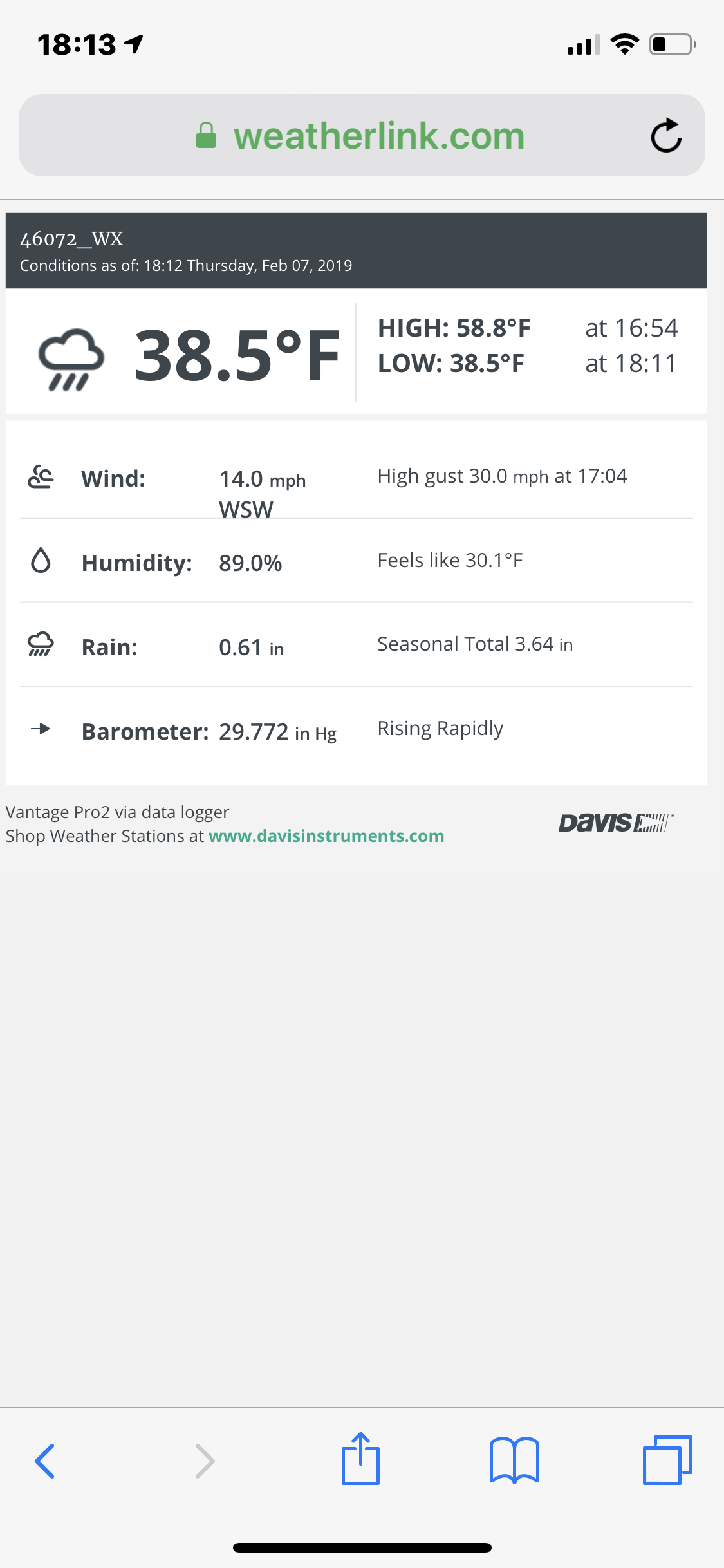

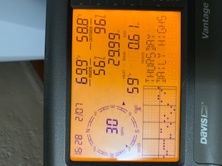

I have a meteobridge and the wind high wind reading is always lower than what the Davis console/website reads. Is there a fix for this?

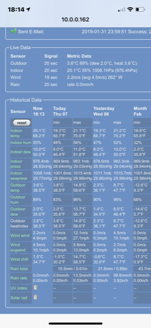

There appears quite a time lapse (19 seconds) in that screenshot with the MB wind live data? How is the MB receiving the data?

The screenshots were taken roughly 2 hours after the high wind was recorded.

When I look at live data, it seems to only refresh at 1 minute intervals. If it is say at the 19 second mark and I wait approximately 5 seconds and manually refresh the page then it says 24 seconds.
Posts: 1476
Re: inaccurate wind speed on meteobridge
Then that says to me there is no wind data available to read and it has been at least 24 seconds since maybe the console received wind data? Does the console reflect this gap?

When I look at the console I see it update wind every 2.5 seconds like it’s supposed to.

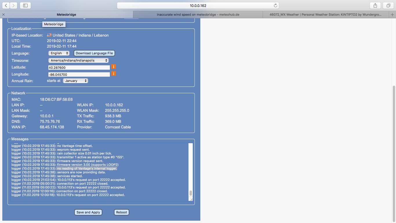

here is a screenshot from my messages
here is the screenshot from my messages
Screen Shot 2019-02-11 at 17.47.49.png (207.84 KiB) Viewed 24469 times

Meteobridge gets LOOP packets every few seconds, nothing for you to tweak.
When you stop your PC feeding WL by taking over control of the Davis logger from Meteobridge (using port 22222 of the Meteobridge) your readings will not miss any gust. Problem with feeding the PC program is that Meteobridge does then not get LOOP2 packets and so it does not get access to maximum wind gusts, which are part of LOOP2 protocol. max wind speeds are still in LOOP packets, but a max gust can be lost when it happens between sending LOOP data.
As I have explained that for about ten times in different posts I think we can close this.
Go with Meteobridge or with WL. Doing both is not working perfectly on wind gust speed. Period.
