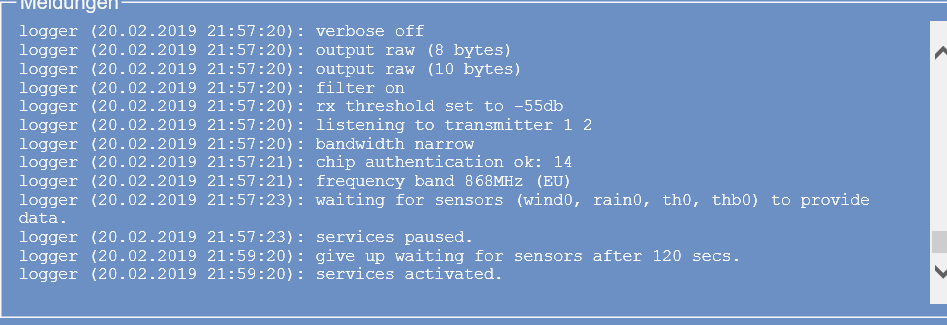

Since 3 Days the Meteobridge pro red dosent work,
I have no Live-Data!! See Log-Files

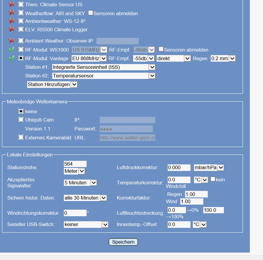

How far away is your ISS & Temp? Has this worked with the RF setting of -55db in the past? Try some different RF settings, like -80db

I change the RF settings to -70db
without success
Is the RF-Modul faulty??

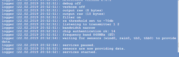

so far it has worked with -55dB
-55dB was very borderline
after a restart and RF setting -70dB, the RF-Modul works again
thanks for your help
