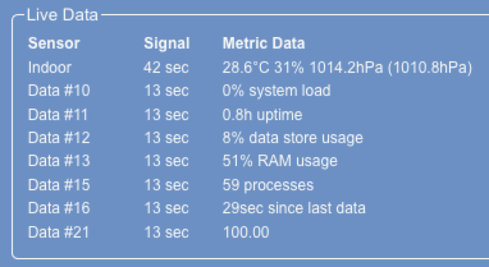

I just read the firmware update log and there is a new update that gives the Meteobridge the ability to handle what is being called alien data. I'd like to understand this new feature better and examples of possible use scenarios. What is this for?
Version 3.9
released March 2, 2019
  • allows to feed alien data (as "data21num") into Meteobridge by providing an executeable shell script as /root/datafeed that returns "data21 xxx", where xxx is an integer number which will be divided by 100 when used by Meteobridge. Example: File "/root/datafeed" is defined as follows and presents value "100.00" on the live data display for sensor "data21num":
#!/bin/sh
echo "data21 10000"
exit 0
