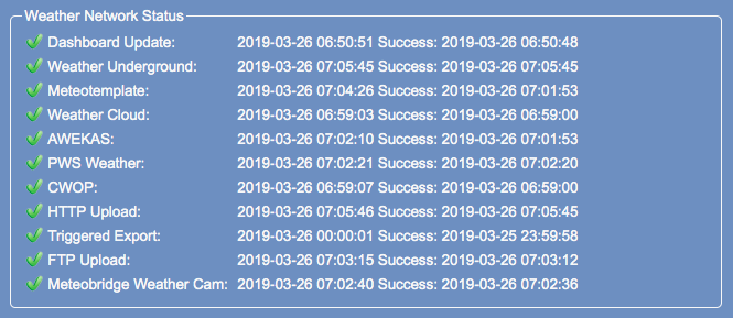

Caught it in the middle of failing. It's up to 330 buffer items. Interestingly, it thinks all the services are working (except none of them have updated in nearly 40 minutes). So something is failing, not showing it's failed, and then causing stuff to back up.
I am ssh'd in. I don't see anything in logs that looks suspicious. It can contact everything. Buffer seems to fill up pretty quickly... up to 411 items now.
Is there any way to either go back to a previous 3.9 firmware, or disable the LOOP2 experimental code? This started with that release...
Rebooting the unit since it's stuck at this point. =( Otherwise I might as well set a cronjob to reboot it nightly. =(
staze
Posts: 198
Re: Buffer filling to 100% after about 36h
Post by staze »
Hmm, interestingly, meteotemplate seems to indicate it has kept updating even though this screenshot seems to disagree.
